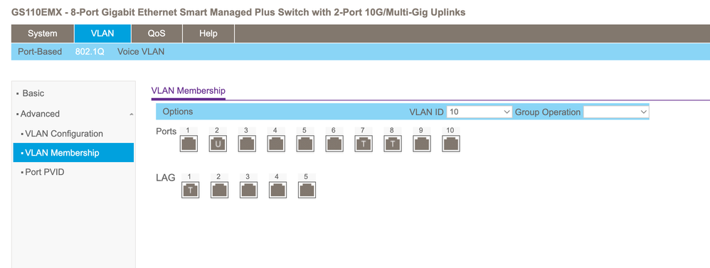

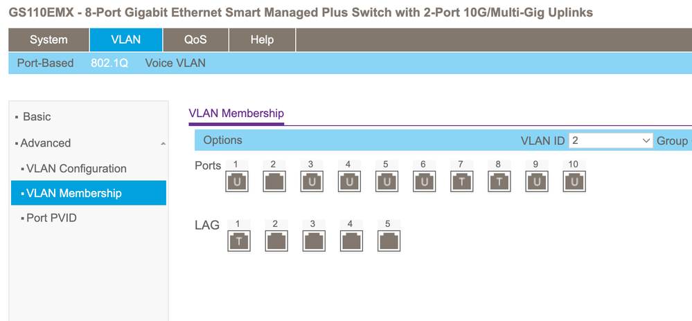

Port 2 untagged on VLAN 10, PVID set to 10
Ports 1-6, 9, 10 untagged on VLAN 2, PVID set to 2
Ports 7/8 (LAG 1, LACP) tagged on VLANS 2 and 10, PVID set to 2.

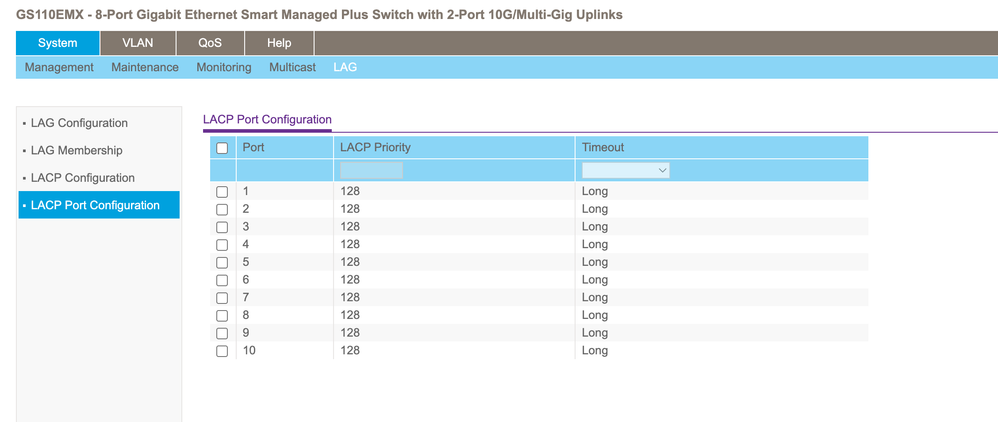

Attached below is a series of screenshots showing the configuration and the resulting PCAPs. Is there anything I'm missing, or is this a failure of the switch hardware itself? And yes, I did powercycle it to make sure that wouldn't change anything.
GS110EMX configuration:

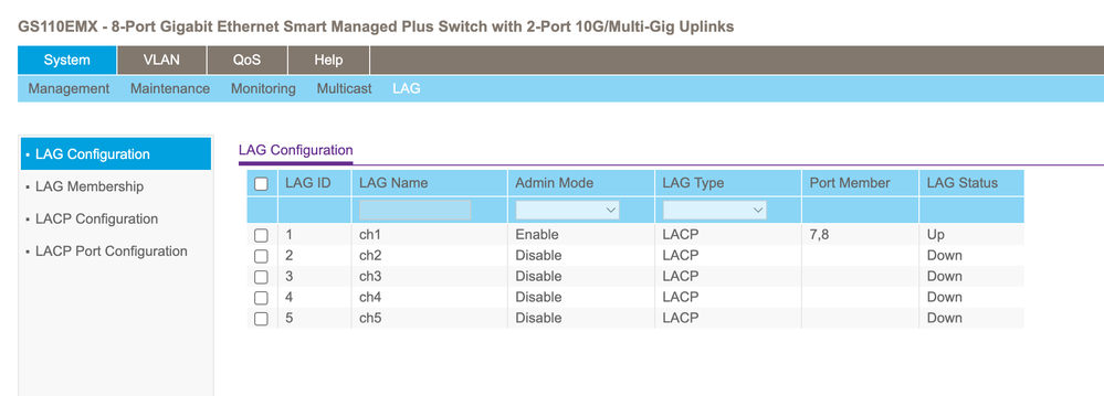

LACP configuration for LAG 1 on Ports 7-8:
LAG 1 Enabled and set to LACPPorts 7,8 assigned to LAG 1LACP System Priority set to default 32768LACP Priority and Timeout set to default 128/Long801.Q Configuration:

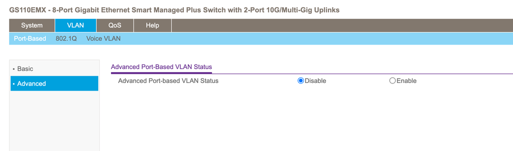

Basic Port-Based VLAN Status disabled

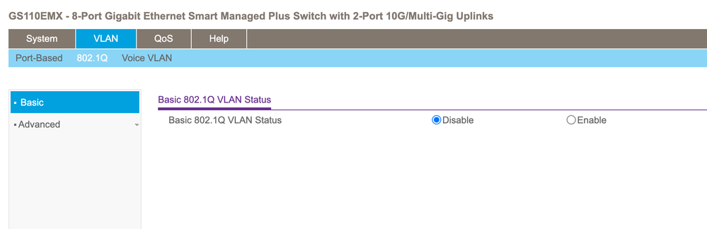

Basic 802.1Q VLAN Status disabled

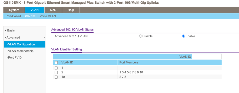

802.1Q Configuration:
VLAN Configuration showing VLAN membership status for all VLANs: VLAN 1 with no port members; VLAN 2 with all ports as members, VLAN 10 with ports 2,7-8 as members.VLAN Membership for VLAN 2 - Ports 1,3-6,9-10 untagged, Ports 7-8 (LAG 1) taggedVLAN Membership for VLAN 10 - Port 2 untagged, Ports 7/8 (LAG 1) taggedPort PVID configuration: Port 2 PVID set to 10, all others set to 2Client sending broadcast DHCP Discover requests to untagged Port 2. These packets did not appear in a pcap on the upstream router running at the same time.
