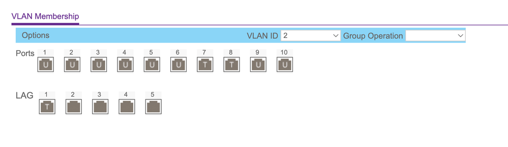

I've had this switch for quite a while but haven't had a need to configure VLANs until now. I've started by moving all the ports to Vlan 2, and configuring ports 7 and 8 - part of an LACP bundle - as tagged interfaces .

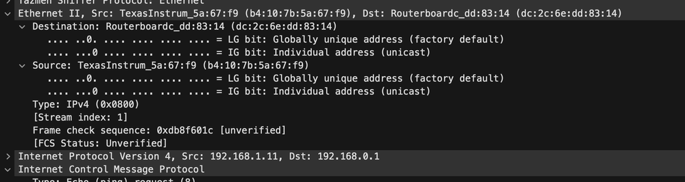

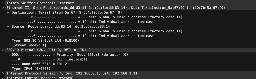

However, pcaps on my upstream router show that frames coming from the switch over the trunk do not have VLAN tags; it's receiving tagged frames from the router and processing those correctly, but there are no tags from frames coming from the switch seen by the router.

Pcap from upstream router shows untagged frames from the switch, while response is properly tagged:

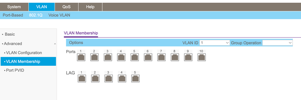

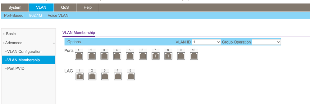

  • Here's the port membership for VLAN 1. The switch won't allow me to delete it, so I only assigned the tagged LAG to it.
    • schumaku's avatar
      schumaku
      Clicking on each if the now [T]agged ports, does not offer the unassigned [ ] - like on all other ports for VLAN 1?
      • cwoodfield's avatar
        cwoodfield

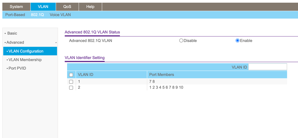

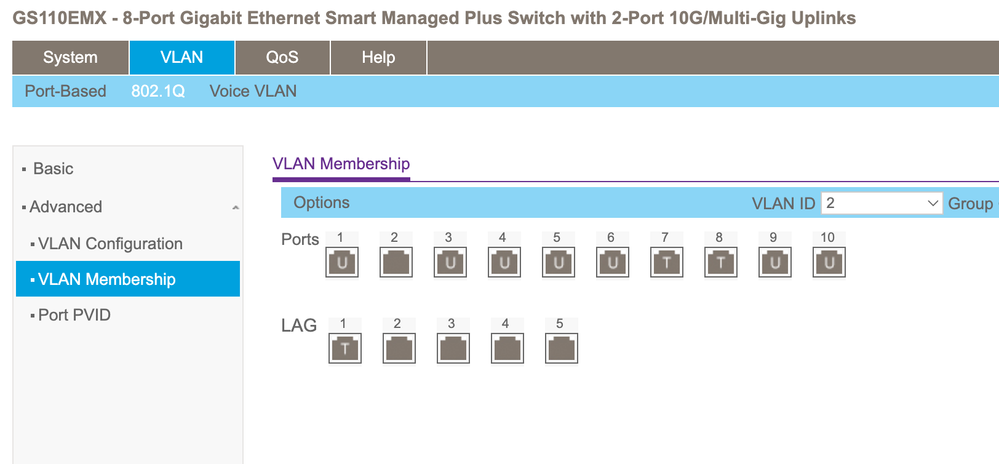

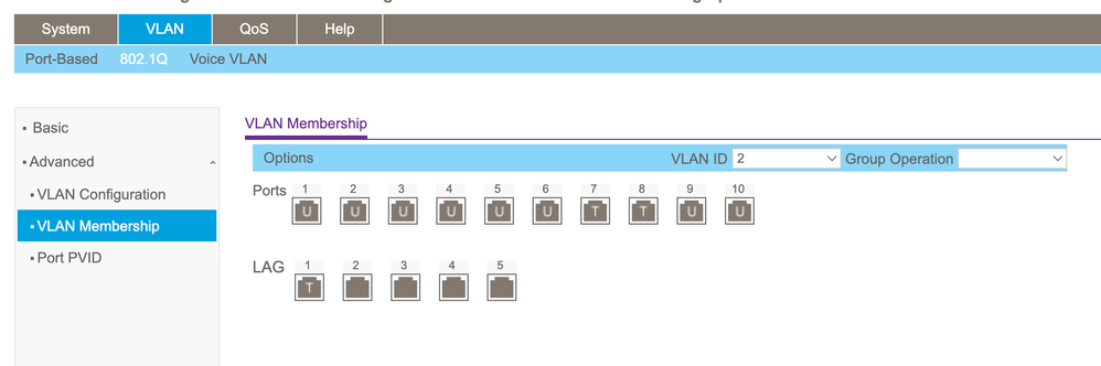

        So it let me remove those ports from VLAN 1 this time - I think the earlier time was when I didn't have Advanced configuration enabled (I remember seeing an error saying that VLAN 1 was required for IGMP snooping, but I'm not seeing that now). So, rescinding my statement above, apologies.
        I've removed those ports (see screenshots of both VLAN 1 and VLAN 2 below), but I'm still seeing traffic from the switch untagged.

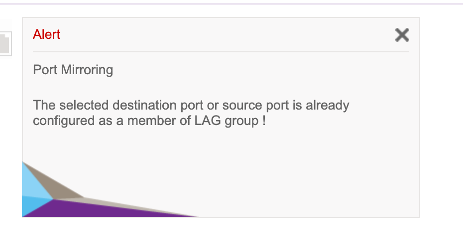

  • As an FYI - I am working on the possibility (albeit unlikely) that my upstream router (a Mikrotik RB5009) is stripping the incoming vlan tags off of the packets before handing them to the pcap process. To test that, I attempted to set up a mirror port on the switch, but it appears that I can't use a member of a LAG group as a mirror source:
  • To follow up - I confirmed via a colleague running the same model of upstream router (a Mikrotik RB5009) that incoming tagged frames do appear in packet captures with their VLAN tags intact, which brings me back to the assertion that the switch is not tagging frames as it is configured to do.
    As mentioned above, the "gold-standard" confirmation, which would be to examine the traffic via a mirror port, cannot be done since the switch doesn't appear to allow a member of an LACP bundle to be used as a mirror port source. Is this a known caveat or is there a workaround?

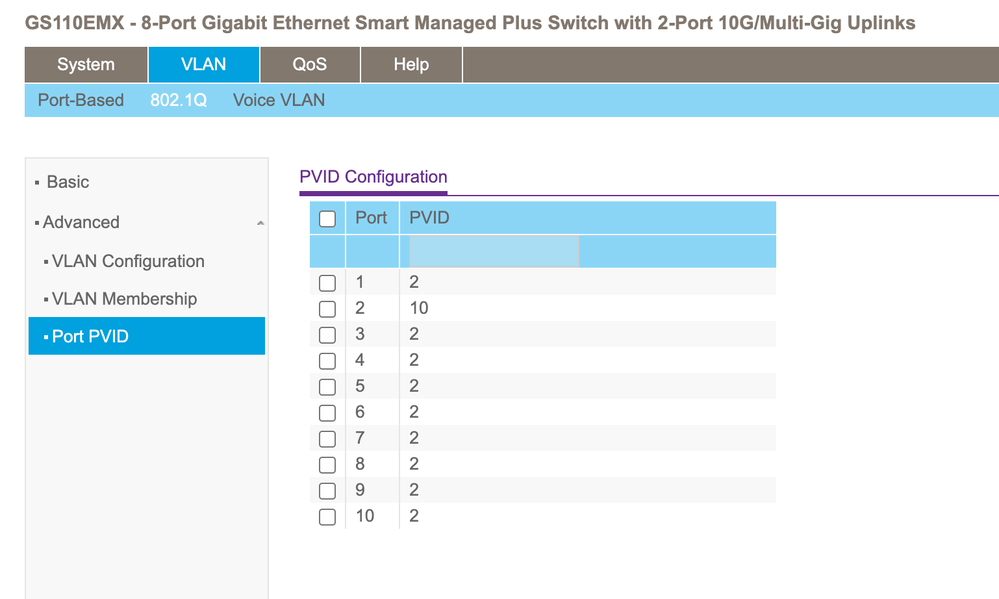

    Port 2 untagged on VLAN 10, PVID set to 10
    Ports 1-6, 9, 10 untagged on VLAN 2, PVID set to 2
    Ports 7/8 (LAG 1, LACP) tagged on VLANS 2 and 10, PVID set to 2.

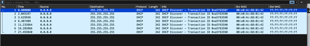

    • Broadcast DHCP requests from my laptop did not appear on the upstream router, at all. No traffic tagged with VLAN 10 was seen (caveat: I did not test the forwarding of non-broadcast traffic sent from my laptop into port 2 using a static IP configuration on the DHCP client).
    Attached below is a series of screenshots showing the configuration and the resulting PCAPs. Is there anything I'm missing, or is this a failure of the switch hardware itself? And yes, I did powercycle it to make sure that wouldn't change anything.

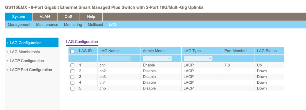

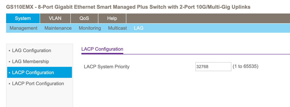

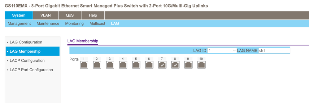

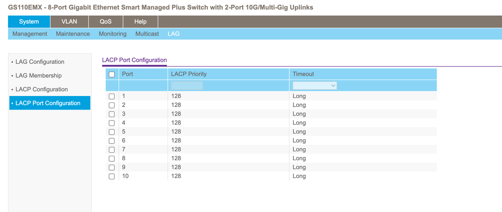

    LACP configuration for LAG 1 on Ports 7-8:
    LAG 1 Enabled and set to LACPPorts 7,8 assigned to LAG 1LACP System Priority set to default 32768LACP Priority and Timeout set to default 128/Long

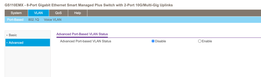

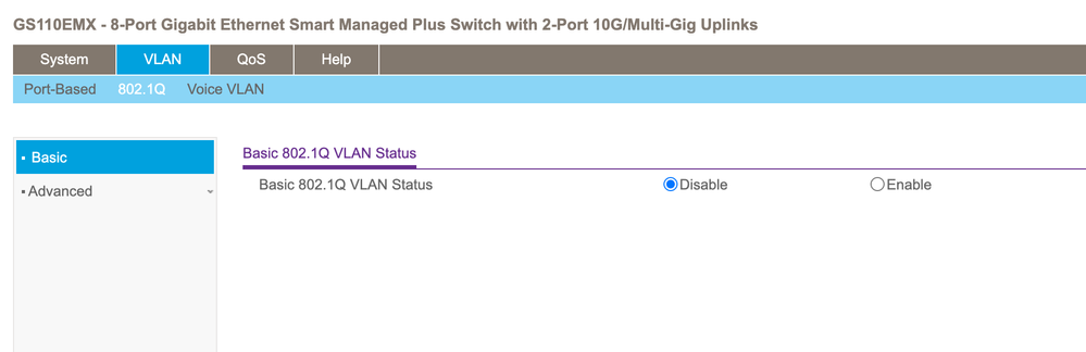

    801.Q Configuration:
    Basic Port-Based VLAN Status disabled
    Basic 802.1Q VLAN Status disabled

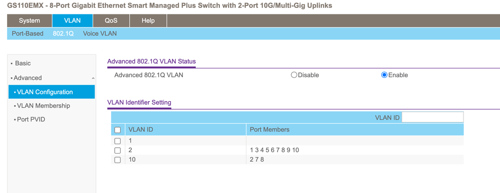

    802.1Q Configuration:

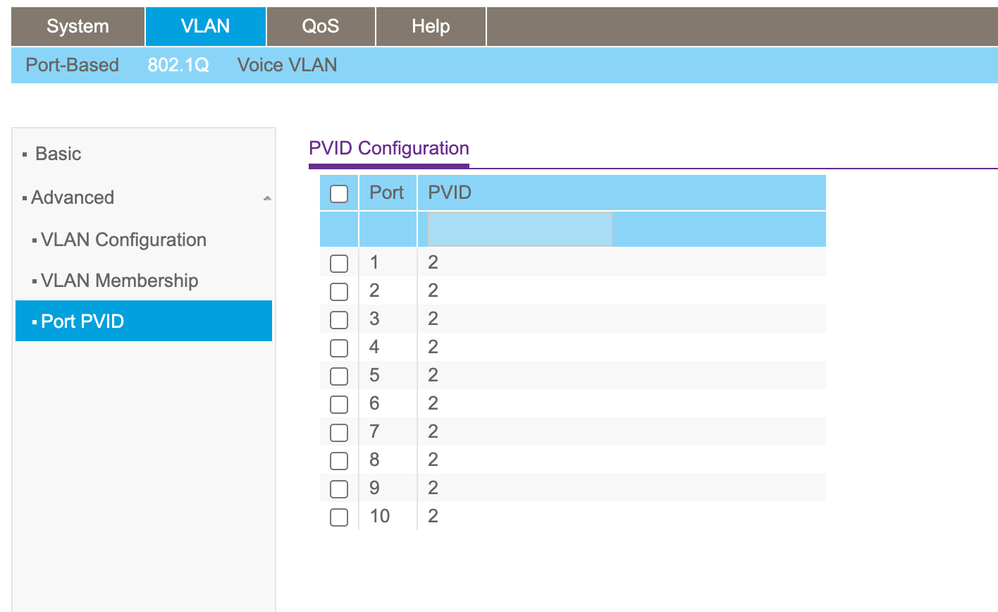

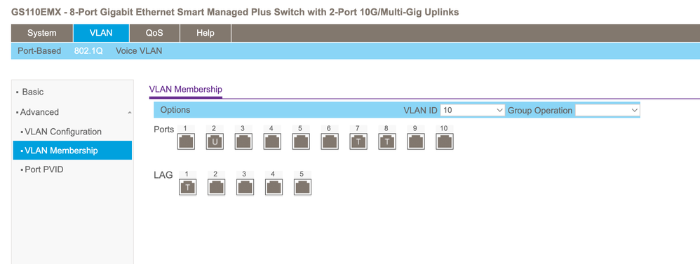

    VLAN Configuration showing VLAN membership status for all VLANs: VLAN 1 with no port members; VLAN 2 with all ports as members, VLAN 10 with ports 2,7-8 as members.VLAN Membership for VLAN 2 - Ports 1,3-6,9-10 untagged, Ports 7-8 (LAG 1) taggedVLAN Membership for VLAN 10 - Port 2 untagged, Ports 7/8 (LAG 1) taggedPort PVID configuration: Port 2 PVID set to 10, all others set to 2Client sending broadcast DHCP Discover requests to untagged Port 2. These packets did not appear in a pcap on the upstream router running at the same time.
