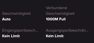

Much more interesting would be what the switch port status show on each switch Web UI.

Were you able to check the switch port status shown in the web interface?

- miclinerJan 25, 2024Aspirant
If you mean this ... yes
This is true for all ports except the rpinter which is not able to do 1000m Full.
