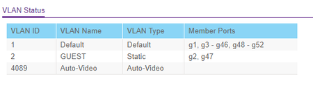

Hello, I've just bought a GS348T switch and after some test for VLAN implementation, I've found a weird behaviour of the switch. The VLAN setup is very simple, port g2 and g47 are in the VLA...

It seems that you are having trouble accessing the management GUI once you connect a cable from port 47. May I know if the PC that you are using to connect to the admin page is on VLAN 1? The GUI is only accessible to any devices under the management VLAN. By default, it is on management VLAN 1. Please make sure that the device that you are using is on VLAN 1.

The VLAN management is the default (1). We made some test with the switch, and seems that the problem is in our core (mikrotik router and HP switches). After aisle netgear switch and connect other router with VLANs config and DHCP servers, it worked without problems.
Need to investigate and probably change our core to make it work.
