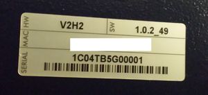

GS724T model version for firmware upgrade
Please help id the correct model (photo attached) of this Netgear GS724T for firmware upgrade.
Thanks

Hi snowdn,
Welcome to the community! :)
I checked the serial number and the switch model you have is GS724Tv2. The latest firmware version that was last released for the GS724Tv2 is v1.0.3_35.
Since you wanted to update the firmware to the latest version, I advised you to do it in a ladderized manner. For example, update the firmware from v1.0.2 to v1.0.3_30. Then, from v1.0.3_30 to v1.0.3_33 and so on until you reach to the latest firmware v1.0.3_35. Be sure to perform a factory reset on the GS724Tv2 switch after upgrading the firmware to the latest version then reconfigure the settings from scratch in order to start clean using the latest firmware version.
You can download the firmware versions for the GS724Tv2 here.
