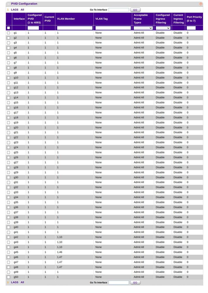

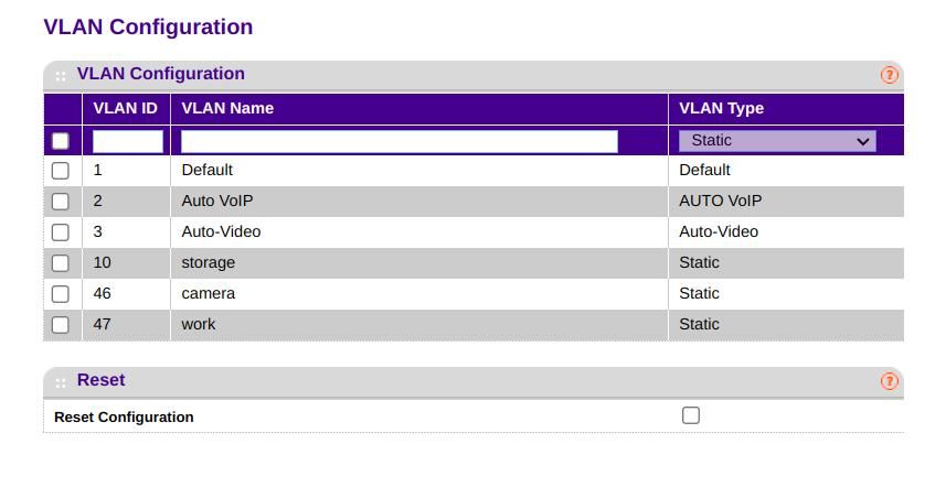

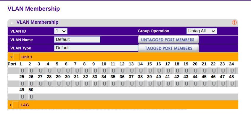

Can anyone tell me why I have to have VLAN 1 Membership set for other hosts in VLAN 47 to communicate with hosts/ports in that same VLAN 47? If I remove the "U" from VLAN 1 (while "U" is set for VLAN 47) for ports 46, 47 and 48, the hosts plugged into those ports can't communicate with each other.
Hosts on VLAN 47 are 172.16.47.0/24 and I just migrated to this GS748Tv5 from a Cisco switch with the same VLANs setup and working.
Screenshots of configuration that works, but why is VLAN 1 needed for 47?

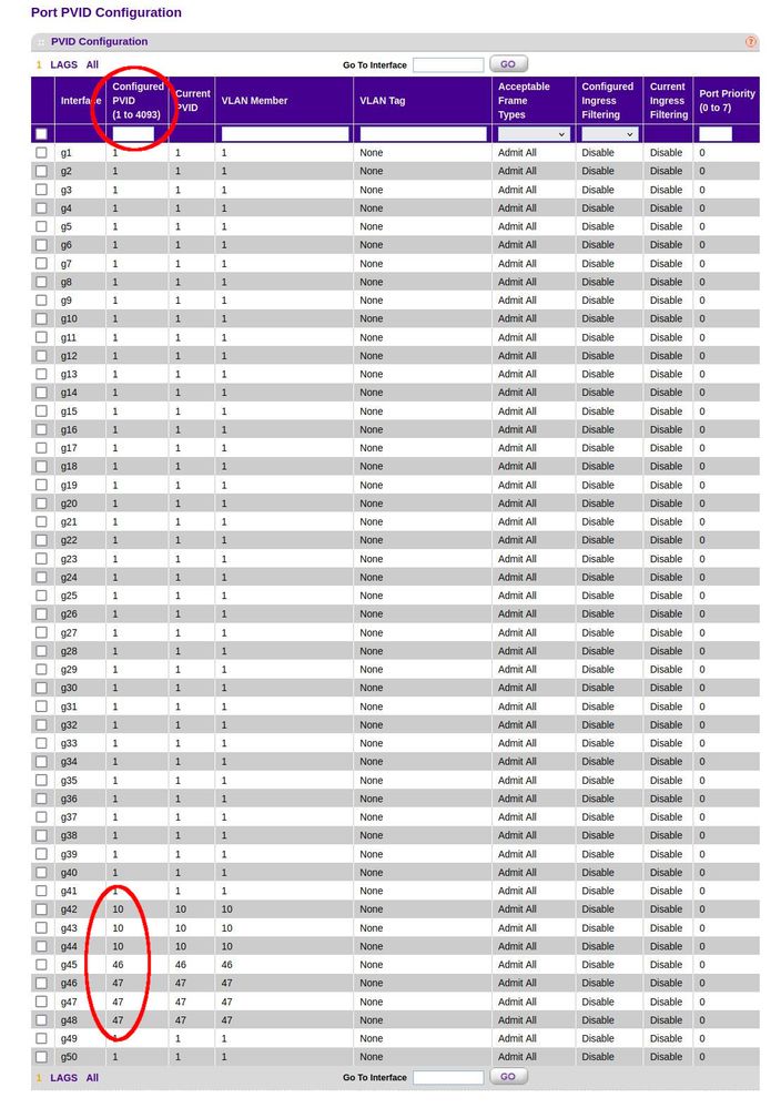

  • I resolved my issue. I had neglected to update the Configured PVID in
    Switching>VLAN>Advanced>Port PVID Configuration
    Once I set these to the correct VLAN IDs, it fixed my issues (screenshot below).
    • schumaku's avatar
      schumaku
      Excellent, most  "classic" mistake.  8-)
