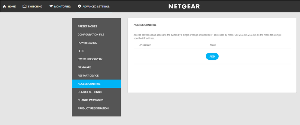

      • Hi,
        I have tried adding my network range to the access control using
        192.168.1.1-254  255.255.255.0
        but it didnt accept the IP address. Would I need to add all ip addresses manually?
