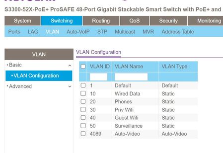

Having trouble programming a M4300 the same as a S3300 with VLANS
Hello, On all of the S3300's I've programmed in the past, I have the firewall control access between VLANS. I connect the firewall on port 1 of the switch. I set all the VLANS on port 1 as tag...
