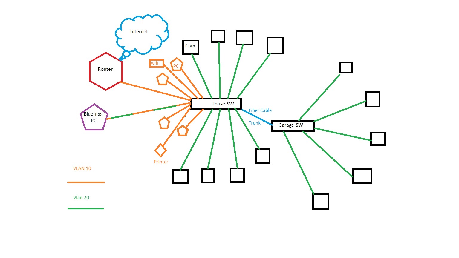

Looking to do something like this.(attached).To keep my Cams from AUTO Phoning Home.......
The Blue Iris-PC has the software to run my Cams. But it also needs to be able to get to the net for time stamps on Cams and VPN for veiwing Cams on my Phone when away...
I would also like to have only 1 Port as the Access for my MGT. Vlan to a PC. Say port 24
On a Side Note..I can use the Fiber Cable as a Trunk even though just 1 Vlan on it ATM ? or would LAG be better ?
