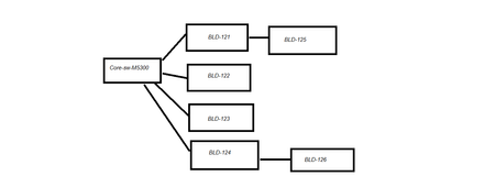

Hi, I am new to this community. My company has implemented Netgear switches in a University. The core switch is M5300 and access switches are GS 728 TP -100EUS. The core is connecting to 4 b...

2) Core can connect all the buildings in star connections but cannot connect the extended building.The diagram above can clarify my issue:BLD-126 can ping BLD-124 but cannot acces the core.
Do you mean BLD-125&126 Host cannot get IP address from DHCP Server? If so please check config as below:
[for example: BLD-126 in VLAN126]:
BLD-126 Switch uplink port(connect to BLD-124) should tagged VLAN126
BLD-124 Switch downlink port(connect to BLD-126) and uplink port(connect to Core Switch) should tagged VLAN126
Core Switch downlink port(connect to BLD124) should tagged VLAN126
Then reload BLD-126 Switch and check if it can get IP address from DHCP Server.

Thanks a lot EricZ. I have upgraded the firmware. The problem 2 hostin different vlans canoot ping but connect each other,I have tried remote desktop connection and it works.May be issue with my Windows firewall.
And my second issue is also solved. Actually vlan 126 in Bld 124 was not created at all , Now I have created the Vlan 126 in Bld 124 and tagged it.
