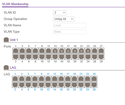

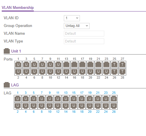

I am having an issue where I have 2 VLANs setup on a GS728TX but when plugged into the second VLAN I cannot access the computers on that VLAN. (IP scheme and subnets are the same).
I have 2 computers with 2 NIC's each on different subnets (Computer 1: 192.168.1.70 and 192.168.2.70; Computer 2: 192.168.1.71 and 192.168.2.71). I have 192.168.1 on VLAN 2 (our Local network) and 192.168.2 on VLAN 1 (our default). The screen shots below are how the VLANs are assigned on the switch. If i plug into one of the untagged ports on VLAN 2 and ping 192.168.1.70, which is also plugged into one of these untagged ports, I get nothing (request timed out/unreachable). Is there something I am doing wrong? Is there a setting I forgot or need to do to allow access? I have a router plugged into the tagged port on VLAN 1 to communicate between VLANs (or so I thought ha)

    The PVID on the "access port" like config for the second VLAN (VLAN 2) is set to PVID 2?
    No other untagged VLANs assigned to the "access ports" for the VLAN 2?
      • schumaku's avatar
        schumaku
        All these "Untaged VLAN 1,2" and "VLAN Member 1,2" are suspect - the view on the 3rd port does not reflect the settings pages for VLAN 1 and 2 above.
