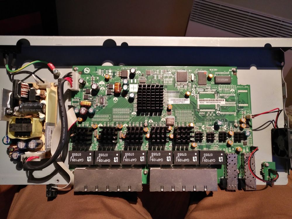

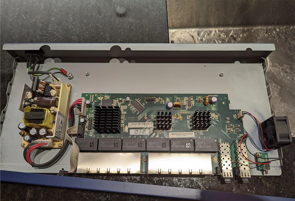

After looking photos of internals for GS724Tv2
and v3
I went to inspect my switch, whereupon I learned that I do indeed have a v2!
