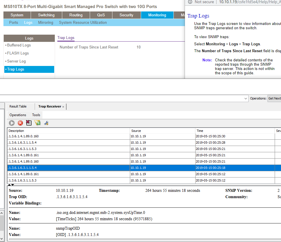

I am in need of some guidance, once again, please.
I am used to Netgear Smart Managed Pro switches having the option to turn on Link Traps at the PORT/LAG level under Switching -> Ports -> Port Configuration
I can't locate any similar option to turn on Link Traps on the MS510TX.
How do I get the Traps to display under Monitoring -> Logs -> Trap Logs as right now that particular screen is empty (only Displays... Number of Traps Since Last Reset     0).
Many Thanks,
-kc6108
  • Aehm, no - the MS510TX online help does mainly mention "the number of traps" for the Trap Logs. Granted, a little bit misleading.

  • schumaku's avatar
    schumaku
    Monitoring -> Ports -> Port detailed statistics does show "Link Trap Enabled" for all ports, FWIW

      That is what I am seeing as well... Link Trap is showing as Enabled on all ports on the Monitoring -> Ports -> Port Detailed Statistics screen.
      I must be missing a setting somewhere?
        Trap Logs
        Use the Trap Logs screen to view information about the SNMP traps generated on the switch.
        To view SNMP traps:
        Select Monitoring > Logs > Trap Logs.
        The Number of Traps Since Last Reset field is displayed.
