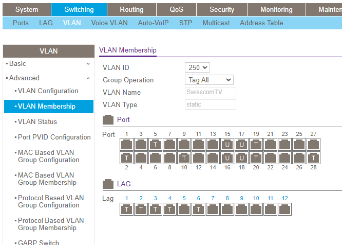

john_of_rohanne wrote:
So, I understand the concept of tagging and untagging - very similar to Ruckus.
Well, as I said: IEEE Industry Standards! Don't blame me for the vendors "hiding" the effective under some fancy UIs.
What I haven't seen so far is an example of multiple VLANs used at the same time on the same interface. Sure we can tag ports 1-5 as VLAN 10, then 6-12 as VLAN 11, but can we configure Ports 1-5 as VLAN 10 and VLAN 11?
There is nothing that stops you. On the UI I've shown above, select the VLAN, e.g. 1, 10, and 11 to configure the port memberships for .... zero rocket science. Look here another VLAN on the very same switch:
Be careful: The UI does allow what is called an asymmetrical VLAN config on ports and LAGs - so please avoid overloading the ports with multiple Untagged settings. Reminder, the PVID does define the VLAN incoming frames on a port resp. LAG are associated to.

Once the VLAN is defined in Switching -> VLAN -> Advanced (also on Basic) -> VLAN Configuration, check the Switching -> VLAN -> Advanced -> VLAN Membership. Select the VLAN, and set the ports required to be tagged or untagged as per our requirements.
