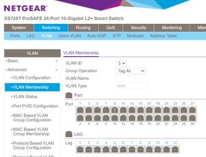

Need help with vlan setup netgear xs728T prosafe
Need help setting up vlans on 2 netgear switches. Here is my setup. Fortigate firewall port 24 is connected to port 27 on netgear xs728t The interface "lan" on firewall has sub-interfaces with v...

Solution:
- Starting with firewall, have interface "lan" setup with sub-interfaces with vlans (no change here)
- Netgear xs728t switch, created vlans and tagged ports 9 for both vlan1&5 and then tagged port 27 for vlan5
- port 27 is uplink to firewall
- port 9 is link to gs110emx switch(port 10)
- Netgear gs110emx switch, created vlans and tagged port 10 for both vlan1&5
BTW: computer on port 1 on gs110emx is getting DHCP from firewall!!!
Below are supporting pic
Firewall "lan" interface
XS728T Switch
GS110EMX Switch
