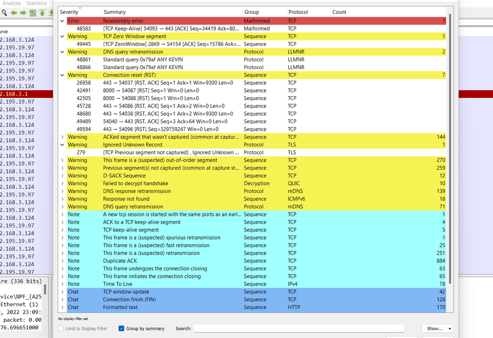

- barrettusaDec 01, 2022Tutor
Last thing I looked at tonight was a packet capture when trying to download a large file (small files seem to work), I'm not 100% sure I know what I am looking at but these warning may help identify my problem?

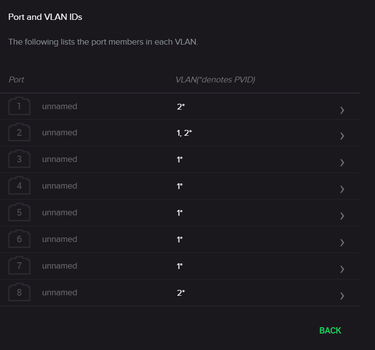

You are making me feel much better 😁
So, I couldn't find the PVID and realized that I was in basic not advanced, so I switched to advanced and recreated the VLANs
Does this look correct for the GS110EMX?
I think I am starting to understand this VLAN stuff much better now, thanks again for your assistance!
