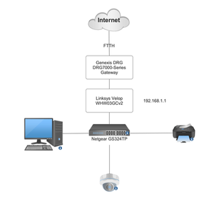

Home LAN basically as shown in diagram. Has been working well for a couple of years using an unmanaged 8-port Linksys (LGS108P). 8-ports no longer enough, so I'd like to replace switch with a Netgea...

SidHarberbridge
Jul 27, 2024Aspirant
thanks Schumaku,
I've rebooted and from the network adaptor it looks like it now has an address in the correct range. But that IP,
192.168.1.34 doesn't reach the web browser interface of the GS324TP – just gets a "Safari can't open the page because the address isn't valid" error.
