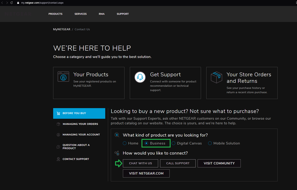

Exactly how do I reach out to Netgear support? It seems they only accept vulnerabilities through Bugcrowd for select products and not this product.
- FURRYe38Apr 24, 2025Guru - Experienced User
Try thru NG official support site:
https://my.netgear.com/support/contact.aspx
https://www.netgear.com/support/contact.aspx
