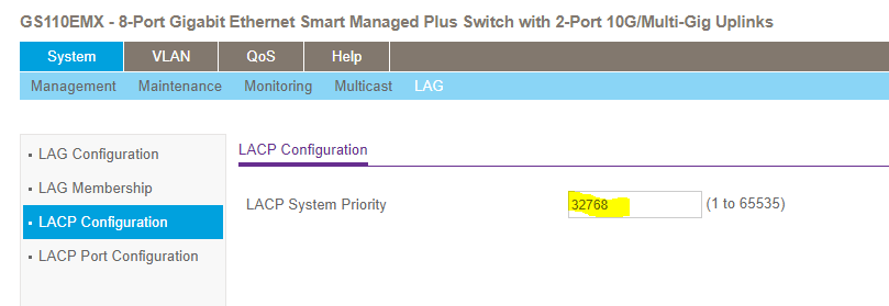

Hello,
I have setup my new Synology DS224 NAS with LAN1 & LAN 2 ports for Link Aggregation in Synology Control Panel but on the Netgear Switch GS110EMS Static LAG only works but LACP does not. (It always says Down not Up). How can I get this to work in LACP mode?
  • Current firmware in place on the GS110EMX?
    Correct ports configured as the LAG members on the switch?
    LACP System Prio on the default 32768?
    LACP Port Priority 128, Timeout long?
    Enable LACP on the Syno again
    Run these commands and post the output to the community:
    ifconfig -a
    brctl show
    ifconfig | grep Link
    cat /proc/net/bonding/bond0

      I finally got this working following the detailed guide your provided. It was very helpful. Thanks!
      Vic
      • schumaku's avatar
        schumaku
        Thank you Vic. For the other readers, please let us know what you have found to be wrong in your configuration? The only variant from the default config would be the port numbers...
