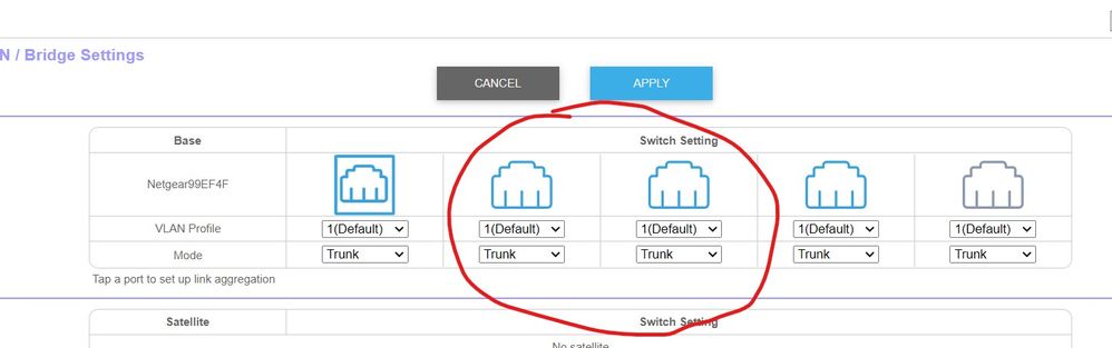

I replaced my Asus RT-AX86u and my router to my Synology NAS does not work anymore.
I had "bind" the port (tried both Trunk and Access).
I lost my access to my NAS after the "bind".
If I removed the bind, I gain access to my NAS again.

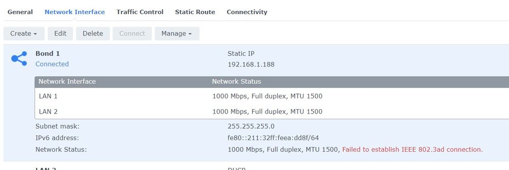

On my NAS (without the bind), I got the below error.
I had tried and confirmed the below already.
1. My 2x NAS ethernet cables are connected correctly
2. I tried bind before I connect the NAS
3. I tried connect the NAS and then bind
I am at a lost when I can try next.

  • Solved my own prob.
    SRX80 only supports static LAG.
