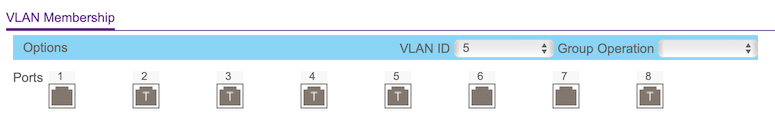

Let me present the details. The OPT port on the Netgate 1100, to which the GS108PEv3 is connected, is tagged with VLAN IDs 5 and 6. The GS108PEv3’s Port 8, which connects to the Netgate 1100, as well as Ports 2–5 are tagged with VLAN IDs 5 and 6:

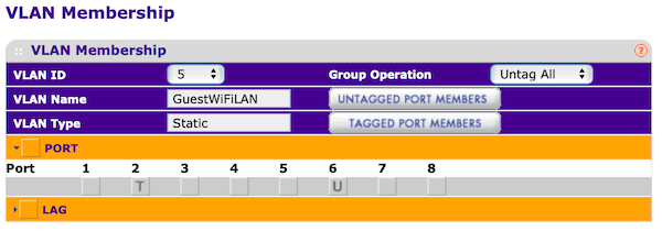

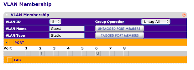

 Ports 2–4 connect to the access points, and Port 5 connects to the GS108T’s Port 2. The GS108T is configured like this:

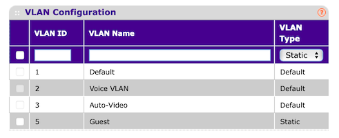

Is it correct to configure Port 6, where I want to plug in my laptop as “U?” I take it to mean that the “U” strips VLAN tag with the ID 5, which my laptop would not be able to be configured to do on its own.

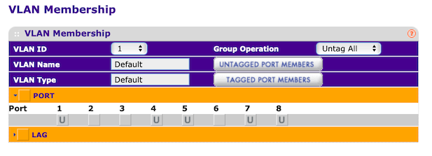

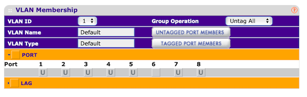

Just so the untagged regular network does not leak through to port 6, I have configured VLAN ID 1 like this:
 The other configuration pages on the VLAN tab are set up like this
Is there anything wrong with these?

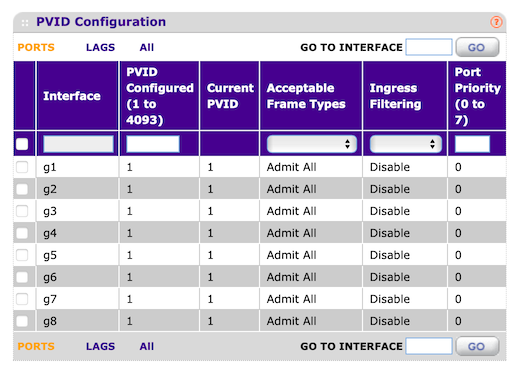

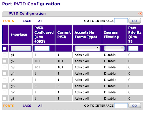

    You talked of VLAN ID 5 and VLAN ID 6. For an access port, making one port untagged, it's not sufficient to assign it to the VLAN ID intended, you need to set the port PVID to assign untagged frames to the VLAN intended.
    Completely confusing to the reader here is that you talked of configuring a VLAN 1. Can't see where or how that VLAN ID 1 is supposed to be used. What do you intend to achieve with this VLAN 1 config?
    update: Re-reading shows the intention for VLAN 1 is having some ports assigned as untagged access ports for the VLAN 1. Is this VLAN 1 used as another network, like a generic network as available on an ISP router LAN port?

      The way I understand it, which is why I am happy for you to correct me, if I get this incorrectly, VLAN 1 is the ID on the basis of which the switch behaves like any unmanaged switch. I therefore made Port 6 on the GS108Tv2 neither tagged nor untagged for VLAN 1, because I don’t want that port to carry any of the untagged traffic.
      I am applying to the GS108Tv2 what I learned from the GS108PEv3: On the GS108PEv3, all ports are untagged for VLAN ID 1. This leads me to conclude that if I make one of those ports neither tagged nor untagged, it will not receive any of the default untagged traffic.

        On the GS108PEv3 I did not have to mess with the default PVID configuration to get it to behave the way I wanted to. Consequently, I didn't do anything with that set of configurations on the GS108Tv2, either.
        Nothing difficult, not a steep learning curve involved The PVID defines the VLAN untagged frames sent into the port will be assigned to. sure, if all you ever need are port based VLANs, the simplified controls are sufficient.

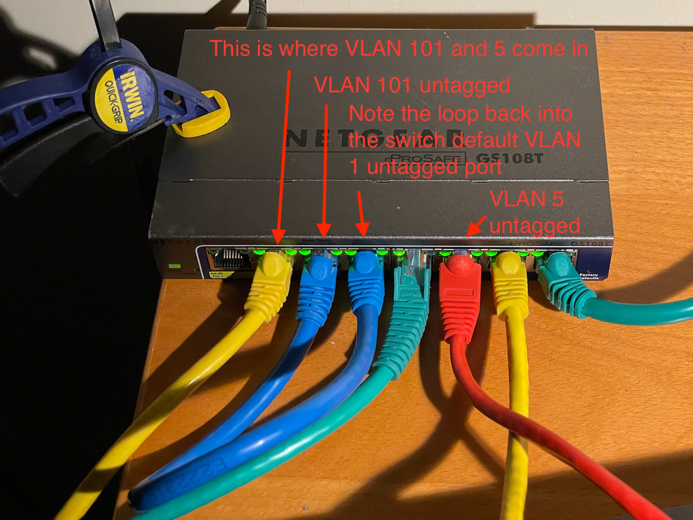

      schumaku: Your hint to setting the PVID of the port from which I needed to untag default PVID 1 was the pointer in the right direction. I got it all working now.
      This is my physical setup:
      Port 1, 5, 7 and 8 are on untagged VLAN 1 ports.

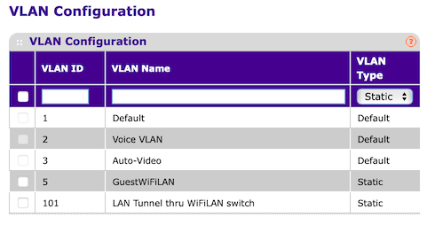

      These are my GUI configurations:
      Again, the purpose is to tunnel my 192.168.1.0/24 subnet through a switch upstream from this GS108T, which is on my 192.168.2.0/24 subnet, to this one. I am using a VLAN 101 tag for that. This makes Ports 1, 4, 5, 7 and 8 essentially like an unmanaged switch that’s part of the 192.168.1.0/24 subnet. It also allows me to send VLAN 5 to Port 5, which makes it part of the 192.168.5.0/24 subnet, which is my guest network. I have hooked up my work computer to that, because I don’t want some IT guy from work being able to snoop around my personal setup. I work for a very large employer with very nebulous IT support.
