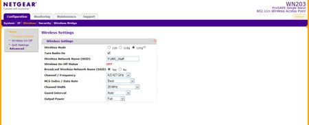

WN203 doesn't get proper IP allocation from router when using VLAN 1 wireless connection
Using an FVS318N router and WN203 access point, I'm setting up a church network to support church staff on VLAN 1 and wireless guest connections on VLAN 2. When I connect wirelessly to the access po...

Actually, the network I'm putting in the church does use a GS108E with VLAN management. I experienced the same problem when using that switch as I described in the beginning of this discussiion. For management of the network I'm using a laptop plugged into port 1 of the GS108E at the left of the config in place of the "Staff Switch". The WN203 I'm using is plugged into port 2 of the GS108E at the left of the config. The rest of the network is not built out yet. Now just using the FVS318N at the left of the config, the GS108E at the left, and the WN203 at the left as described. No modem connected yet. When testing the wireless capability of the WN203 VLAN's 1 and 2 got the ipconfig's I included in the start of this discussion. VLAN 2 worked fine, see the ipconfig. But, VLAN 1 didn't get a valid IP from the router, see the ipconfig. Here are screen shots of the GS108E setup, and also a network configuration diagram. This really has me puzzled. Any ideas? Thanks for your help DaneA. -- Don

I don't know, but it seems to me like the problem may be with the access point setup or it may be defective. Please, take a look at the access point setup screenshots I provided earlier in this discussion. I have other WN203's I can configure and try if we want to do that.
