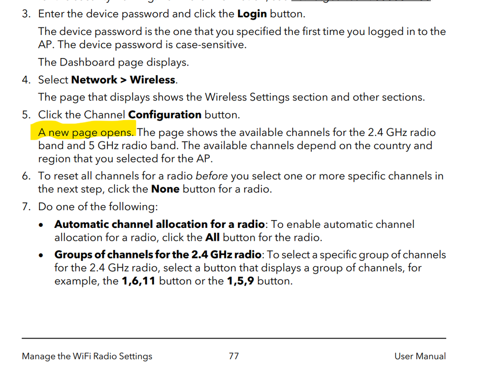

    Can you locate the pop-up window when going to Network >> Wireless on the Web UI?

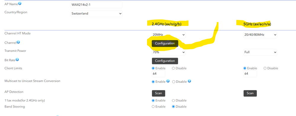

      On my similar (older WAX214v2 version) it's a very unlucky Web UI design :
      Here you can select the band(s) desired, or [All].

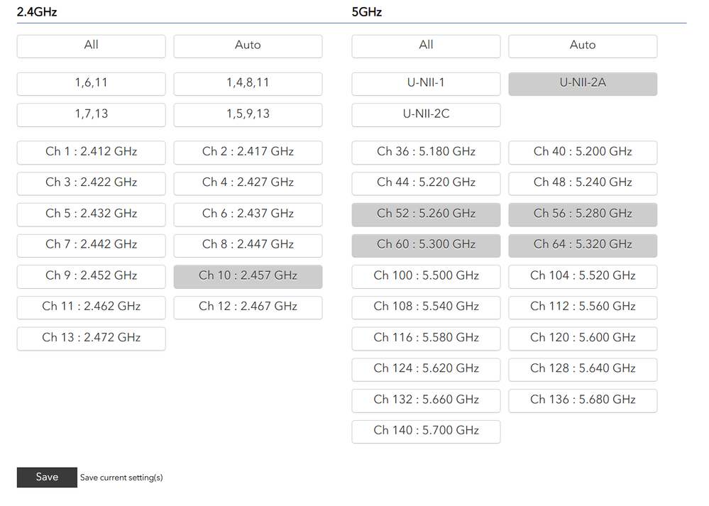

        schumaku​ Thank you for your help!
        Yes, I have found the configuration page. I appreciate your confirmation that at least I am looking in the right place. I am in the United States where the DFS should be available, of course with the access point switching channels if a nearby radar lights up. However, Channels 52-140 are not available in this UI.
