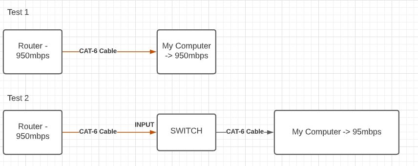

I made a little diagram representing both test
Note that the red cable in test 1 & 2 are indeed to same one
The second cable (black one) of the second test is tested and 100% working at 1gpbs

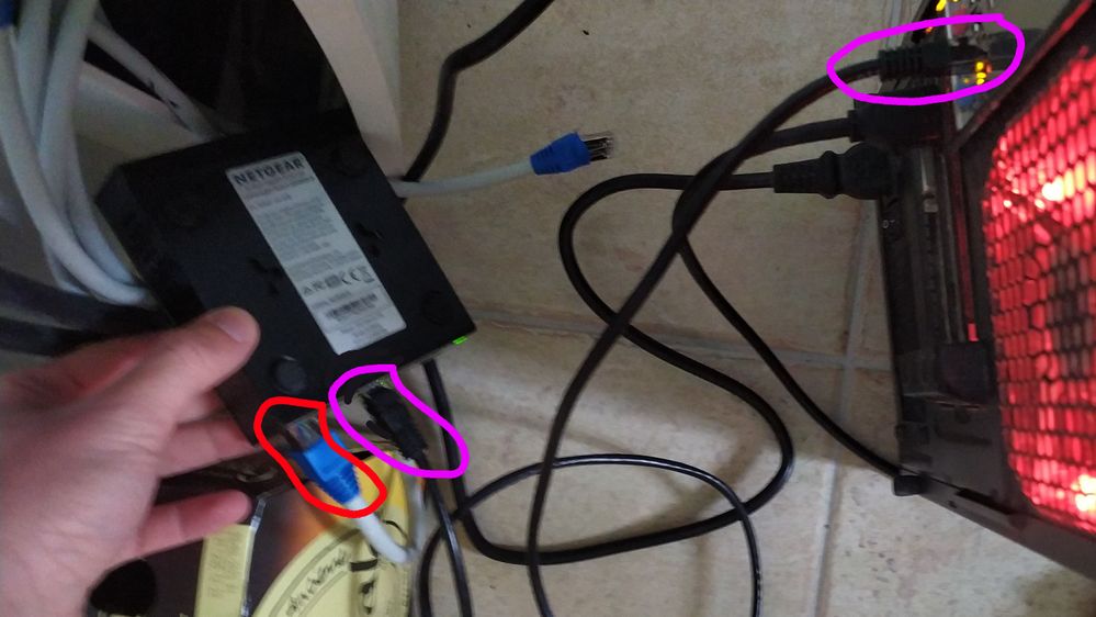

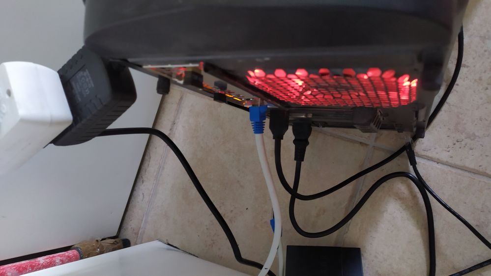

also 2 pictures of the tests
First one just show the input cable being plugged directly into the computer
On the second we see the input cable plugged into the switch (red one) and the second one from the switch into the computer (purples)
