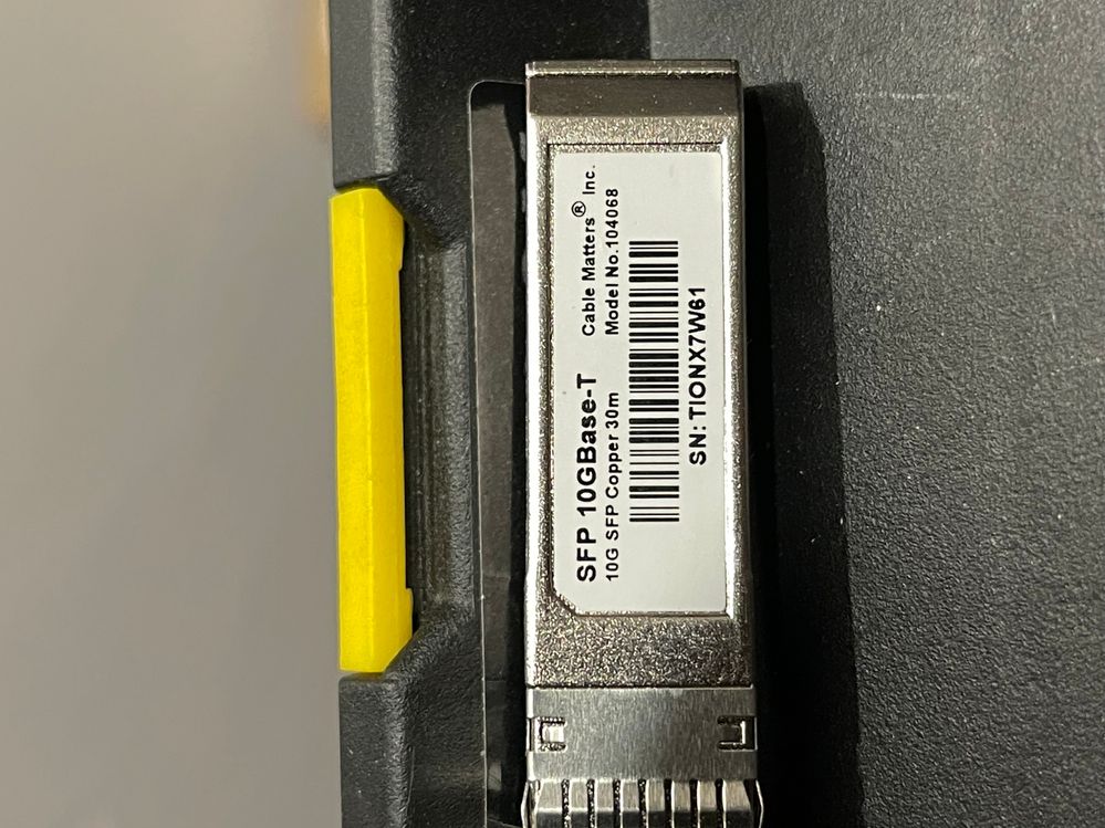

I have a XS505M that I'm curious who can recommend the best branded and model# 10Gb SFP to RJ45 transceiver for this model switch?
I have a Cable Matters branded 10Gb SFP to RJ45 transceiver now and I'm seeing a problem when I have it installed in the XS switch and the CAT6A STP cable running from the XS switch to a GS110MX connected to it's 10Gb port, if I have a Apple TV connected to the GS110MX switch, streaming begins for about a minute the stops. Then all internet and IP addressing services on this segment of the network stop working. I have to power cycle the XS switch to get all services back up and running.

This is the transceiver I got back in June:
Possible this may not meet or be compatible with the XS switch. I do see other brands mentioning NG and other switch mfr names as being compatible. I also see 10Gb speed only SFPs and multi gig SFPs which seem to cost a bit more. I see NG has a SFP to ethernet however seems to be overly prices IMO.
