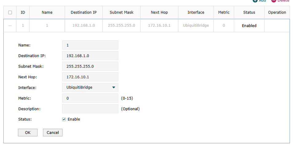

On Building B's side, this is the setup. (TPLink ER605)
This is the static route i created on the TP Link so the Building A network can communicate to the Building B LAN thru what i called "UbiquitiBridge" VLAN.
As you can see, its routing all the 192.168.1.1 traffic thru 172.16.10.1 which is the gateway of the VLAN on the SRX5308 in Building A.

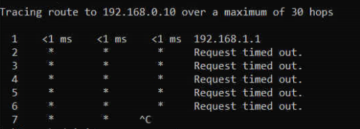

So now it looks like the Vlan is working correctly on the netgear... when i go a trqacert to say 192.168.0.10, the first hop is correct its the srx5308 at 192.168.1.1, but then it looks like its not going to the gateway (Vlan20)'s iip at 172.12.10.1 as the second hop.. Before it was taking the second IP out to the Net, which was incorrect... So im gettin closer. I have to check the config on Building B's router- now
