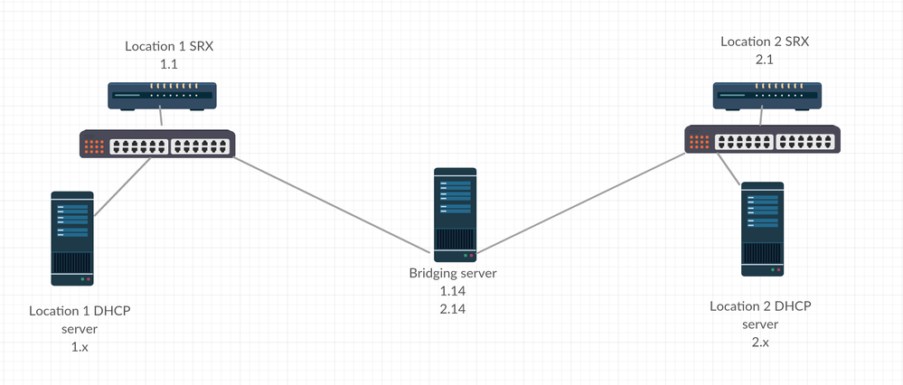

      The SRX units are not serving DHCP. Our AD domain controllers at both sites are doing that. Topology as it is now is basically like this attached photo I made quickly. What we want to do is get rid of the bridging server and just use the SRXs to do the bridging part. Let me know if this helps!
