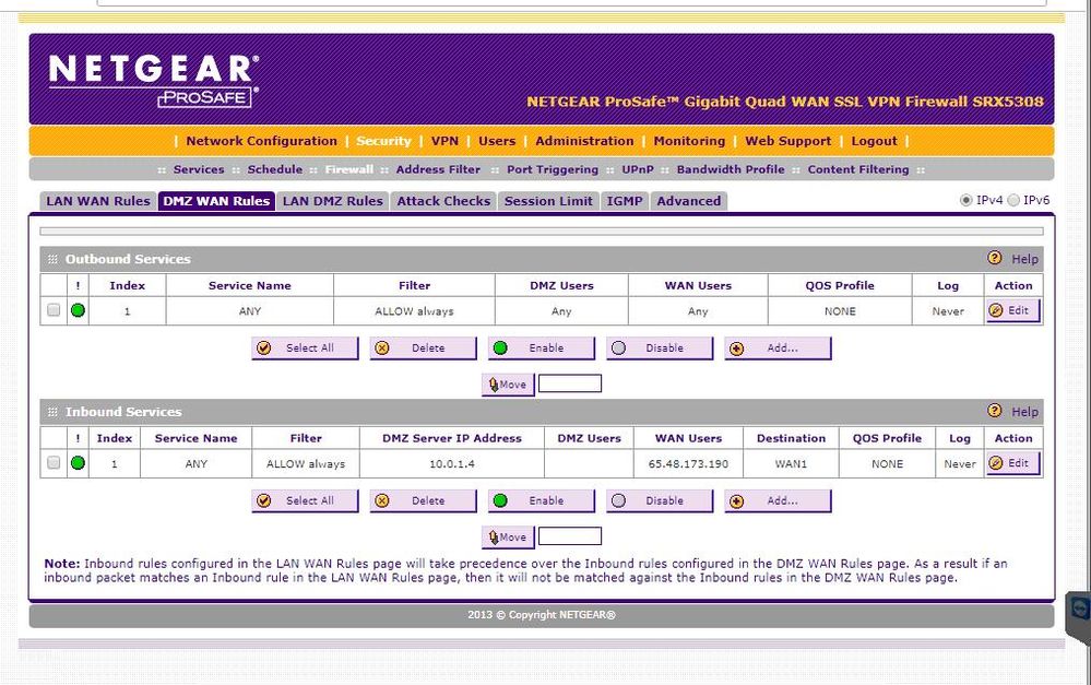

I am able to establish a stable connection through the prosafe easily . I am using NAT  WAN mode. and all of the connected servers are able to establish an internet connection. The issue is a Web server I have exposed on a DMZ however i cannot seem to access it from the outside ( Webpage Unable to load)
I have setup a DMZ server using  10.0.1.1 (255 255 255 0)
 and  VLAN - 10.0.124.1 (255 255 255 0)
The IP setting on the  Webserver Nic is
IP 10.0.1.4
Subnet: 255.255.255.0
Gateway: 10.0.1.1
DNS: 69.57.239.200 / 69.57.239.201
I have created the following rules shown in the screen shot. just for initial testing. i insted to expose specific ports once i am able to access it.
65.48.173.190 is one of my assigned public IPs
Please help me...

    It is not really recommended that you open all of the ports inside your network as it may cause security risk. It might be better if you will just specify the ports that you needed. Have you tried to open only the HTTP port in DMZ WAN Inbound rules? No need to put anything on the outbound. Please also upgrade the firmware to its latest version.

      I have gone ahead and updated to the latest firmware.
      I am aware that it is a security risk to open all the ports. this was created just a temporary measure to access the 10.0.1.4
      I have disabled the DMZ and placed the two servers on the LAN ports with IPs 10.0.1.4 and 10.0.1.5.   all on the same subnet 255.255.255.0

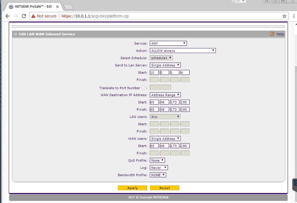

      I have removed the outbound roule as you suggested. and  a created a single rule in the incoming.. Am i creating them right...?
      Thanks for your guidance

        Please set the service to HTTP. It will just cause conflict to other ports and will not work properly. You may also set the WAN Destination IP to a single address as it seems that it was not a range of IP.
