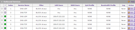

Hi, I am attempting to set up my FVS318Gv2 Firewall so it will block all DNS queries that are not from OpenDNS. I was using this article for reference. To do this, I created a list of out...
- Mar 07, 2017
Mainly a stupid mistake of putting the IPs in the LAN space instead of the WAN space. Also it seems the rules should be the other way. Seems a bit backwards to the way things usually work.
Here are my final settings for future reference:
joelphilippage
Mar 07, 2017Aspirant

I have a question about your configuration. I am trying to do the same thing. Do you need to have the configuration in the inbound rules also? I would thing it would just be outbound.
Thanks for posting your solution!!!!
D
- joelphilippageJul 25, 2017Aspirant
No. I found that wasn't necessary.Thanks for checking.
