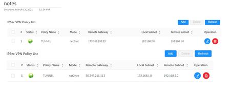

I have 2 BR200 routers and 2 locations I set up site to site IPsec vpn Tunnel is green I can ping IP's from either site back and forth I cannot however map drives to my server from remote site ...

I may be confused with the local and remote subnet.
since bith BR200 are attached to an existing router which provides the internet connection the WAN adress of the BR200 are respectively
on a LAN subnet of the router. 192.168.1.0 (Office) and 192.168.20.0 (remote)
Both BR create their own LAN subnet. 192.168.11.0 (Office) and 192.168.21.0 (remote)
Which LAN subnet is to be used in the Ipsec config?
Which ports shall be forwarded from the Internet router. 500 and 4500 are the ones I used

Are both BR devices behind a router? If so the issue would be double NAT and the route is not able to complete directly. Can you verify when both routers are not being another router if the tunnel does complete? You can follow the guide below to make sure your tunnel is correctly configured:
If the tunnel does come up after removing the other router we can troubleshoot the double NAT issue if needed.
