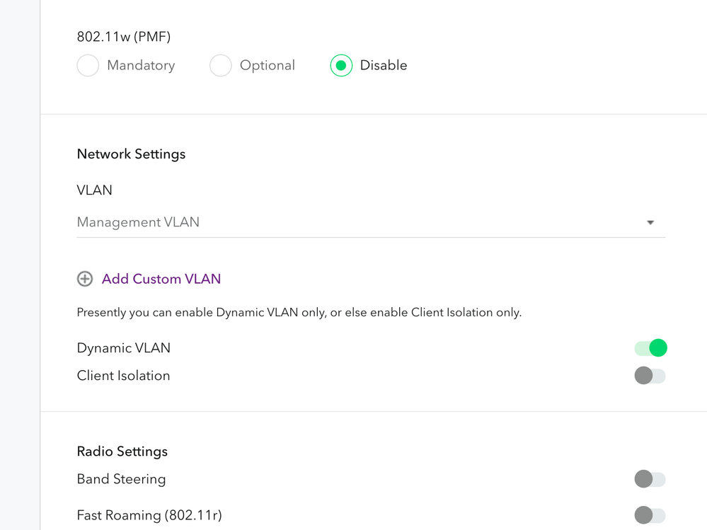

If you have Insight management enabled. you can enable Dynamic VLAN at the SSID configuration.

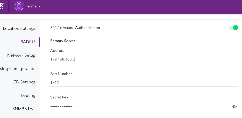

Step 1) Go to location configuration and set up the RADIUS server

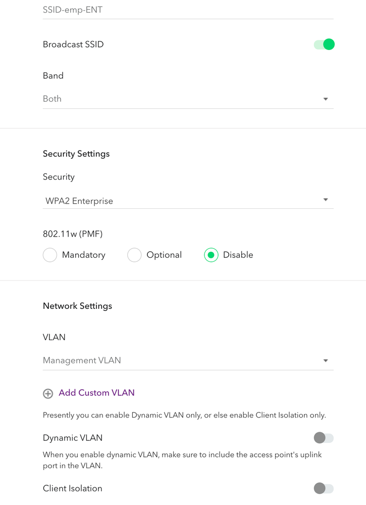

Step 2) Go to wireless settings and enable Dynamic VLAN.
To make it actually work,
Please make sure the ethernet port where the AP is connected is a TRUNK and allows all VLAN on which the client joins.
