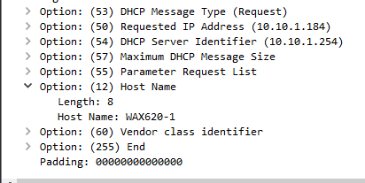

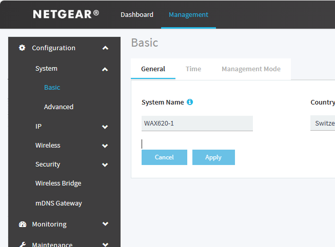

The WAX620 for example (all WAC5xx or WAX6xx) allow the configuration of the System Name
...which is nicely used by the embedded udhcp and requested with the DHCP request Option 12 ...
Needless to say, you need to configure the System Name on the WAX620, in my example above it's WAX620-1 - and can't depend on the DHCP supplied Host Name from the local DHCP server - with the name not configured, the default name will be there ...
