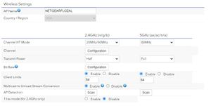

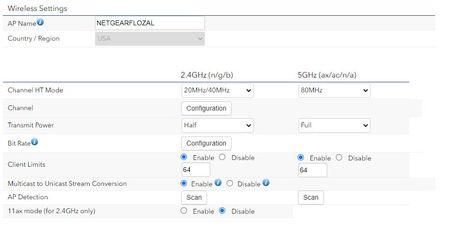

NetGear AP WAX214 - AX 1800 Cannot Connect Android Device
I'm Receiving the following Error While Trying to Connect to the AP an Android 11 HK1 MAX TV Box (mac address 5c:f8:a1:a1:e9:d7), I was able to connect to a old LinkSys Router without Issues but af...

What type of security are you using?
- crfloresJan 27, 2022Aspirant
The Security is WPA2-Personal
- plemansJan 27, 2022Guru - Experienced User
what channel are you using for 2.4ghz?
Have you tried changing?
What's the android device giving you for an error?
At this moment is set to All
Yes, I have tried to change it to 1, 6, 11
No only that cannot Find the NetWork.
but as you see on the original message of this tread, on the logs seems at first that is authenticated and then associated, but inmediatly gets disassociated.
