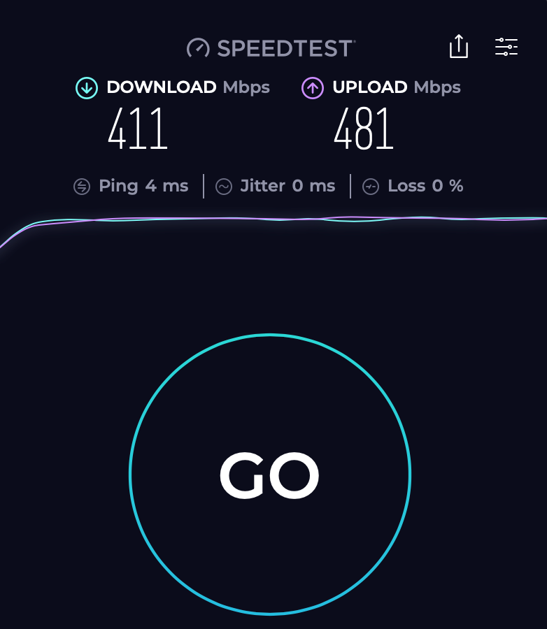

Also, as you can see, I am in front of my WAX630E with my iPad Pro getting Speedtest.net results just a couple of minutes ago.

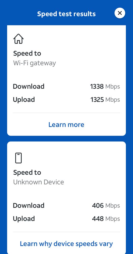

I called NETGEAR Support and they said that whatever the speed of my internet is, cut it in half, which is why I was getting about 400 up/down. That sounds correct with half duplex, but I am running on a full duplex at 5G on port 1 as shown below. Still around 400ish up/down. I could never even get past 500 on an internet speed test where I am getting roughly around 1.3G up/down.
And as you can see, Port 1 is showing at 2.5G, which is still way above my internet speed so the modem/router port 1 is fine! Support even asked me to connect the WAX630EP AP directly to this port, which I did but still same result. That is I bypassed the switch. Strange that the Netgear AP and router doesn't seem to bring value to my effort since my current home setup with the Araknis switch and AP already gives me roughly the same speed. So why even keep these Netgear equipment if it doesn't bring speed or value to me?? Does anybody have any thoughts?

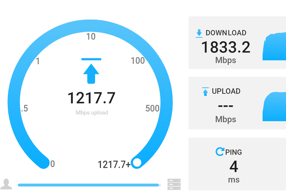

Here what a random 802.11ax client can do on a similar Netgear 802.11ax AP connected through a MS108EUP can reach easily on a HTML5 browser based test - 5 GHz band 2.402 Mbps physical link rate on 160 MHz bandwidh (file name is wrong - it's an AX link)::
Protokoll: Wi-Fi 6 (802.11ax)
Sicherheitstyp: WPA3-Personal
Netzfrequenzbereich: 5 GHz
Netzwerkkanal: 40
Verbindungsgeschwindigkeit (Empfang/Übertragung): 2402/2402 (Mbps)
Hersteller: Intel Corporation
Beschreibung: Intel(R) Wi-Fi 6 AX200 160MHz
Treiberversion: 22.200.2.1
Physische Adresse (MAC): 34-CF-F6-E5-CD-47Yes, measurement using is done by https://openspeedtest.com/?ref=Offline-Outro&Auto=5 on the LAN to a QNAP TVS-675 with a LAG connecting two 2.5 GbE links for experimentation - same numbers with just one physical link..
