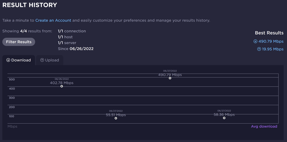

One laptop on my network is an Asus A15 gaming rig with an upgraded AX210NGW wireless card utilizing windows 11 and Wifi6E 6GHz with wpa3. Even when connected from this laptop I'm still only receiving roughly 50Mbps/down on a wireless speed test. Here are my historical speedtest.net results, the first result is during initial setup and the subsequent results are the unacceptable speeds I'm currently getting. Firmware version on the AP is 10.1.9.2. I would be greatly appreciative of any guidance that can be given here as I do not want to have to return the AP and start over with another offering.
  • Putting the AP on a separate management VLAN that wasn't a part of any of the SSIDs VLANs resolved this slowness issue. No idea why it resolved it or why it caused the issue to begin with. But speeds are back to "acceptable" now.
