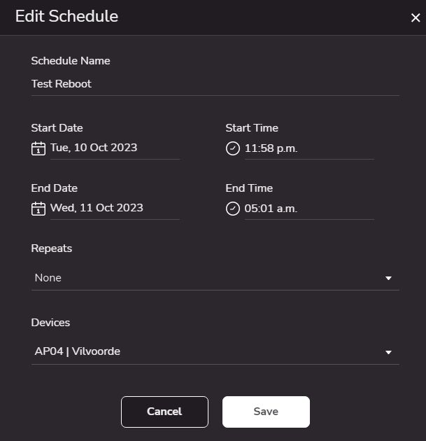

Hello,
We are trying to schedule a monthly reboot for our Access points but the schedule does not seem to be triggering.
The schedule is configured under organisation settings -> Device Reboot.
I added a screenshot of the settings below, but if i understand it correctly, the start and end datetime define a period where the access points try to reboot.
We selected all 17 devices where only 2 of them are different models.
I feel like it's hard to mess this up, but are we missing something that is preventing the schedule to trigger?
(Repeat is disabled since we wanted to see if it even works to begin with)

    This does look like the (one fo three possible) time windows to have WiFi active.
    Just naming the schedule as "Test Reboot" does not make it a reboot trigger.

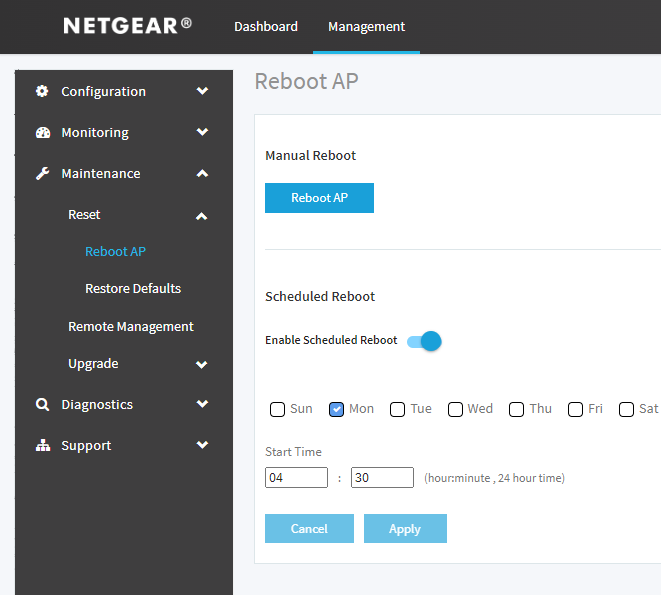

    Yes, defining a reboot schedule is available - when I have it right only on the local device Web UI under
    Maintenance -> Reset -> Reboot AP -> Scheduled Reboot

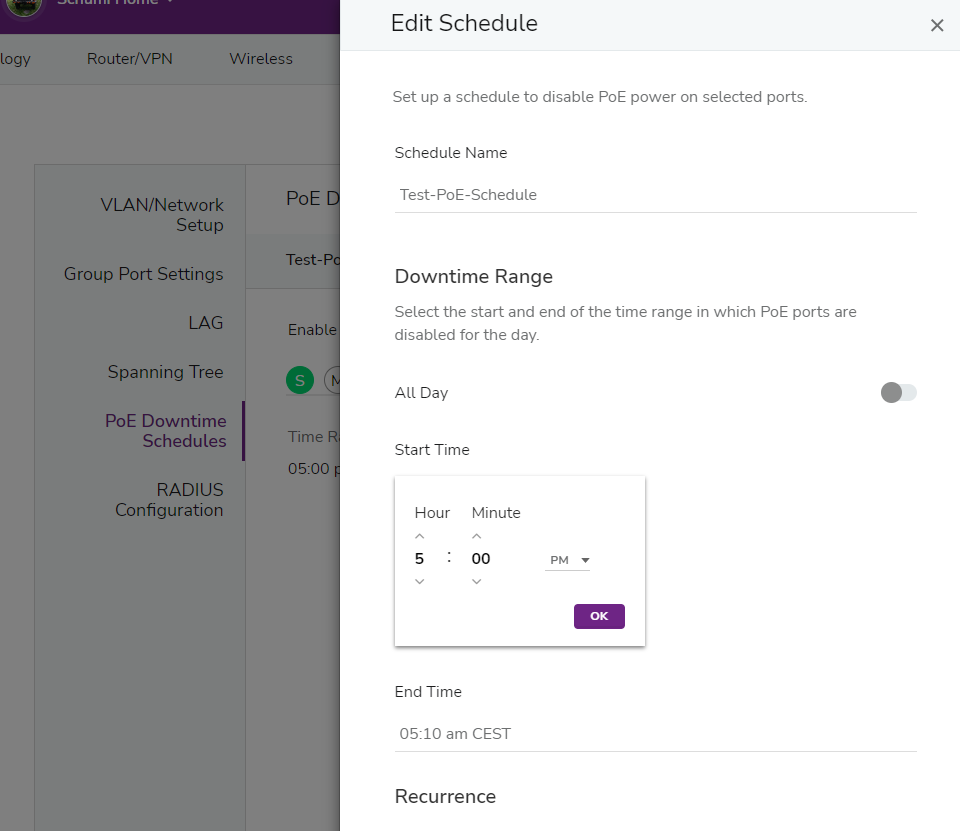

    Sure, there is an option to define a PoE Downtime Schedule - this applies to the Insight managed PoE switches:
    JulienR please tell me what I have missed here 8-)
