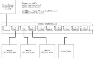

 I'm trying to set up a small network for a church.  it will have three WAC510's connected to a GS116Ev2 switch all connected to a Comcast gateway something like this.  It will have one private and on...

The WAC510 has 2 radios and each can have 4 VLAN's (total of 8VLAN's). Each of these can have its own DHCP server where you can set an address range and mask. Some traffic will be get its IP address from the WAC510's but some will get it from the Comcast DHCP server because they're Ethernet connections to the GS116. Comcast will assign a 10.1.10.xxx address. I'd like to have a full 254 address range for my two WIFI VLAN's. If I set up the WAC510 DHCP's to assign 192.168.1.xxx, can a WIFI device 192.168.1.7 access the printer with an address 10.1.10.3 or is this not a problem?
