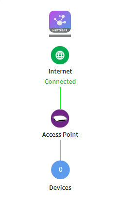

WAC540 not connecting to Insight Cloud
I went to manage my devices on Netgear Insight and discovered that only one of my devices shows as connected. Same for accessing insight from my tablet or from the web. The ones I wanted to chec...

TimothyGaray
Jun 04, 2024Aspirant
I should also mention I changed one of them to web mode (it rebooted) then changed back to Insight mode (it rebooted) and still will not connect.
