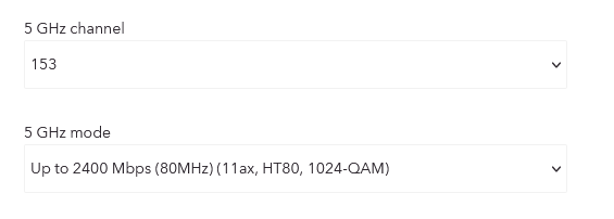

Hello, schumaku.

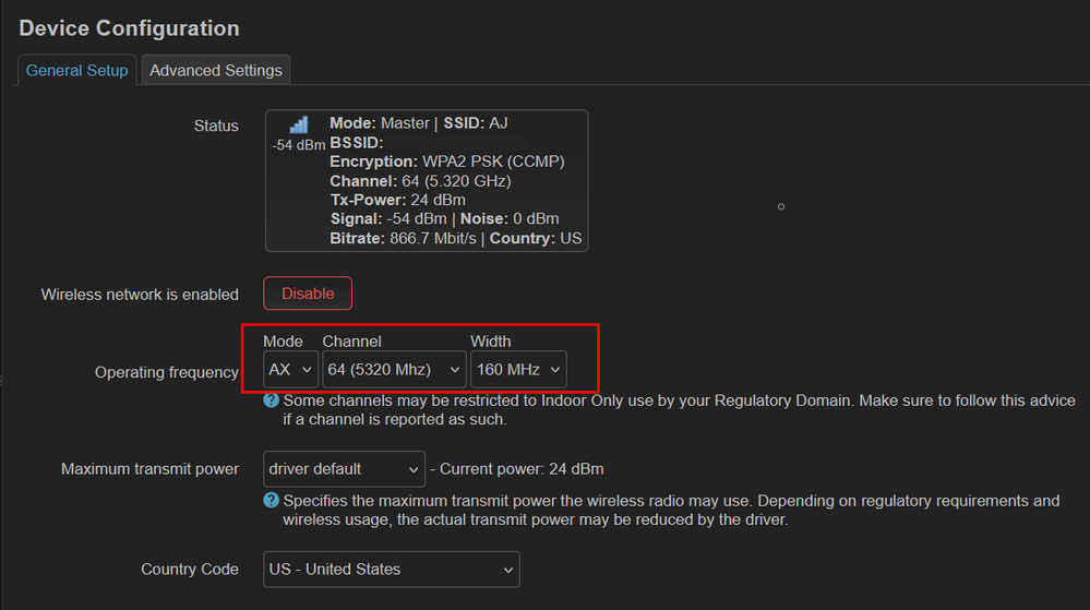

Thank you for responding. The 5GHz mode is already on 80 MHz at 2400 Mbps, which is the highest setting available. I am also on channel 153 which does not have any congestion at all in my area. Please refer to the following screenshot:Not only that, but I also resorted to installing OpenWrt which allowed me to unlock the 160 MHz band that the Netgear UI does not allow me to have access to. WAX206 uses MediaTek MT7915E chip which supports 160 MHz but to access it, you need OpenWrt which I installed. I set the channel to 64 since it provided the best speed & reliability results under the 160 MHz band. Please see the following screenshot:
Doing so helped with my laptop’s Intel Killer Wi-Fi 6 AX1650i speed, which went up to 550-600 Mbps down/365 Mbps up. This is much better than my previous results but still does not reach the full 750 Mbps down/375 Mbps up which I’m able to get via LAN. I doubt my AX1650i is limited to only 600 Mbps!
Unfortunately, unlocking the 160 MHz band did not improve my iPhone 14 Pro’s speed test results as they remain unchanged. Again, just like my Wi-Fi card, I do not think this is a limitation in the iPhone 14 Pro’s Wi-Fi.
