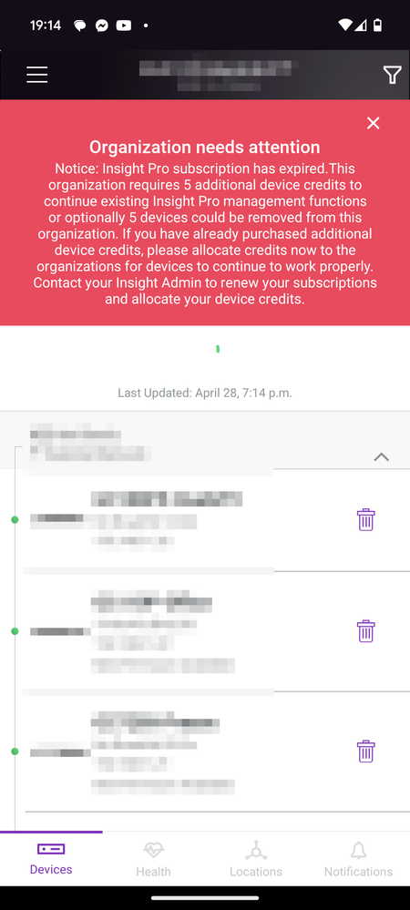

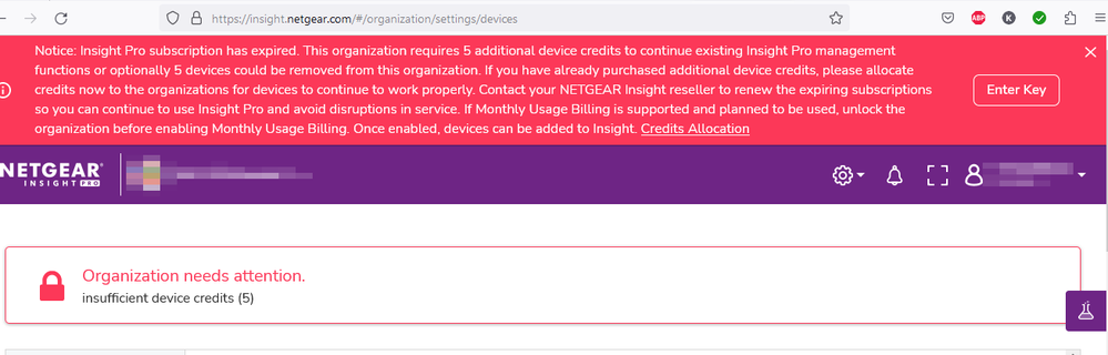

"Device failed to connect back" is what it comes back with and then tells me that An Insight Premium subscription is required.
Your WAX610 came with a 1-Year NETGEAR Insight Subscription Included
Once expired, I don't think the device does report to connect back to the cloud. This is more likely an infrastructure issue, where eg. some firewall rules are blocking the outgoing connection (LAN->Internet).

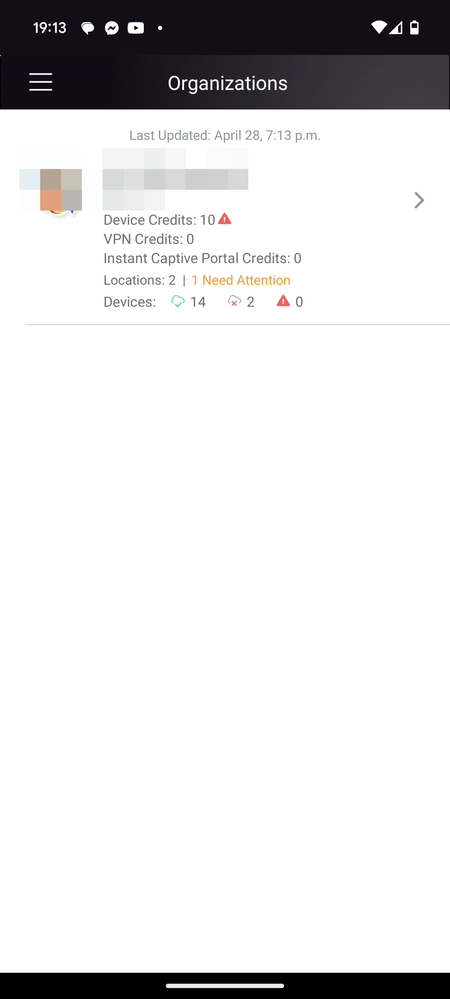

Dispute this with Netgear when it comes to the "Essential" models like WAC2xx or WAX2xx please - which are not Insight manageable, just discoverable in the App. Insight is a key component available for managing any size of network - these WAC5xx or WAX6xx (and WBE7xx) are scaling extremely well to any environment.
Insight is incredibly useful even for domestic or home environments, mandatory for users which intend to deploy WPA3-SAE.
The thing the community should work on is to allow the users to continue their Insight service - what isn't difficult, however this requires some annual service costs - especially if users like to use the Insight App and/or the Insight Web portal.
