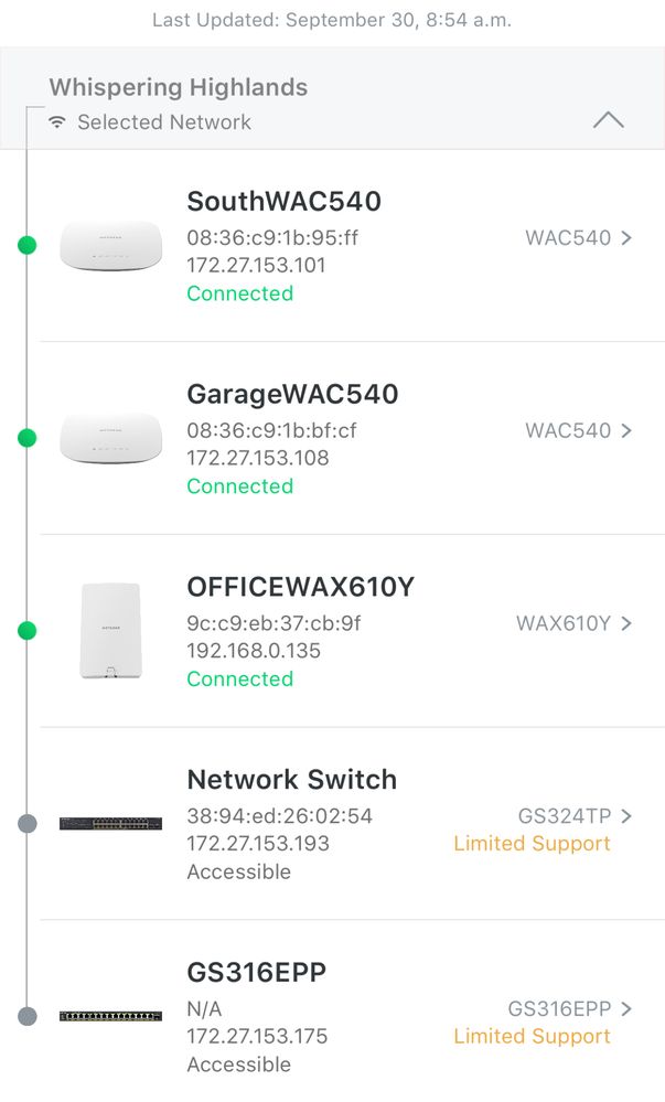

schumaku RaghuHR My setup is 100% Netgear - intended to avoid these issues. I don't have a FritzBox. Like I said before the issues before left the network unusable. Paid for Insight service, it rebooted everything, reprovisioned (not update, everything was up to date) and boom everything started working again and the opposite problem happened a week later. Initial issue was the WAX610Y taking the entire network down, now the WAX610Y works 100% of the time, but the WAC540s go offline and take the entire network (wired too) with it. Then both come back online - both go offline/online together at the exact same times).
C7800 Modem / Router (wifi off) single feed directly to:
Main Switch GS324TP feeds all house ethernet ports, two WAC540s, and feeds directly to:
Secondary Switch GS316EPP (located 75M away in Office) feeds office ethernet and the WAX610Y
Only the Office WAX610Y shows as being on the 192 subnet Main Switch GS324TP = 172.27.153.193 Secondary Switch (located in Office) GS316EPP = 172.27.153.175 Office Access Point OFFICEWAX610Y = 192.168.0.135 Garage Access Point GARAGEWAC540 = 172.27.153.108 Third Access Point SOUTHWAC540 = 172.27.153.101 My Insight app says the GS324TP is "available" but when I try to access via ap or directly via IP nothing loads. Same with the WAC540s
