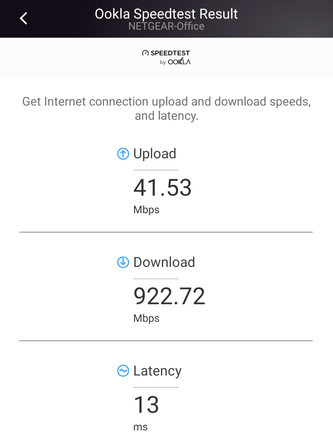

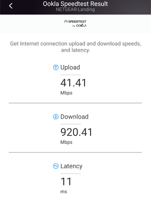

The results?
The Pixel 7 now gets 785mbps down and 40.7mbps up
The iPad 11 now gets 435mbps down and 31mbps up
The MacBook Pro 14 now gets 786mbps down and 33mbps up
The real question is why isn't this the default configuration for these APs? Why not ship for max speed then let admins tweak as needed if the high performance settings aren't what they want?
