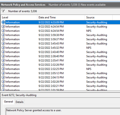

Currently, the workaround is to reboot the specific AP, ask user to re-authenticate, which, first, shows the same error, however, the request looks to be sent to the RADIUS server which then also give a proper feedback and logs the event (see screenshot below):
Checking the radius server logs, it show that the specific user was granted access:
The user can now connect to SSID without any issues.
