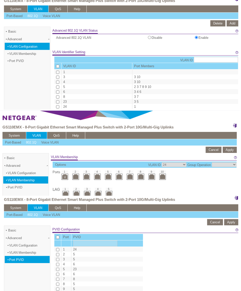

  • OK I have confirmed that I see these ARP's on other vlans too.  I'm wondering if I've done something wrong in the config.  To show the community what I have in terms of VLANS's I made screenshots:
    So on VLAN 4 and 5 (confirmed) I see traffic from VLAN 24, I assume that on vlan5 I can also poison vlan 24 from vlan 5 although I haven't tried that (only on vlan 4).
    I run the latest firmware.  Either my config is messed up or this is indeed a problem with the switch(es).  I realise that port 1 is the only member of vlan 24 and thus the switch may broadcast all ports with this, how would I stop that though?
    The router has 3 interfaces, one dedicated to port 1, one uplink and one that has vlan 5 untagged and a bunch of tagged ones.   There should be no leakage of ARP.
