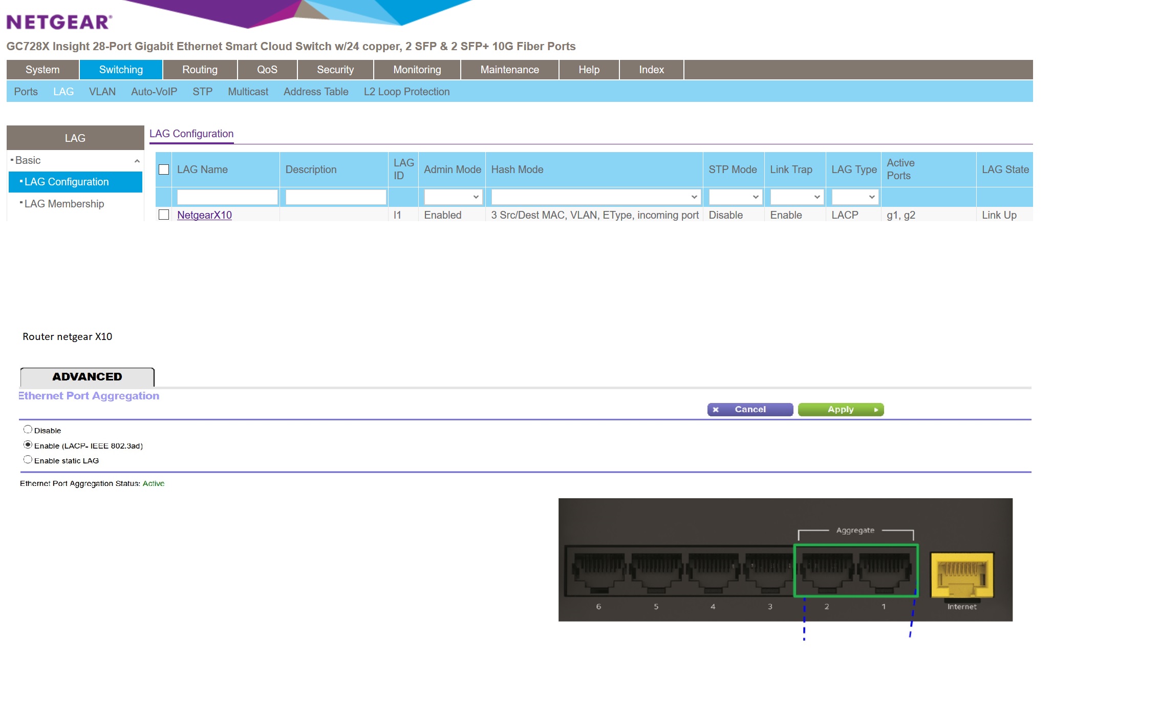

How to setup proper LAG between GC728x and X10
Hi can somebody help my setting the LAG between my Netgear Router X10 and new GC728x ? I try use the LACP on the switch and router, but sometimes on the switch one of the lag ports is down. With my old Netgear GS724T v3 was the setting flawlees
Thx
Hi primus1701,
Welcome to the community! :)
What is the current firmware version of the GC728X switch? If ever it is not yet the latest version, I suggest you to upgrade the firmware. The latest firmware version is v1.0.4.10 and you can download it here. Be sure to perform a factory reset on the GC728x switch after upgrading the firmware then reconfigure the settings from scratch. Then, observe if same problem occurs.
Regards,
DaneA
NETGEAR Community Team

- primus1701Aspirant
Fw upgread done
Factory Reset done
the problem is gone.
Thx
