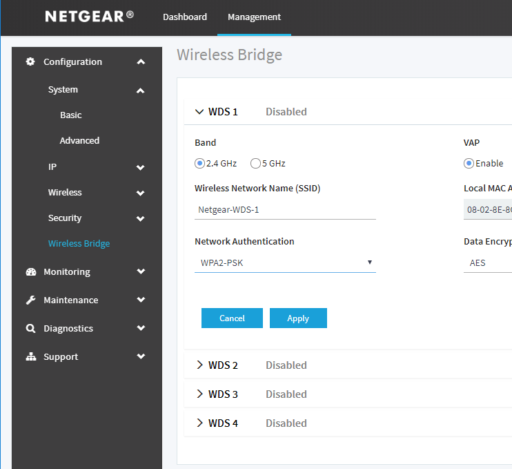

Digging a little bit (but no resources to establish a WiFi bridge) ... on a WAC managed by Insight [while established with a local LAN connection], the WAC does not prohibit the creation of a WiFi bridge:
Has RaghuHR some information to add here? I'm really buffed Netgear does go silent...
There might be some drawbacks - for example the Insight RRM might or might not work, as the channel must be fixed for a WiFi Bridge.
