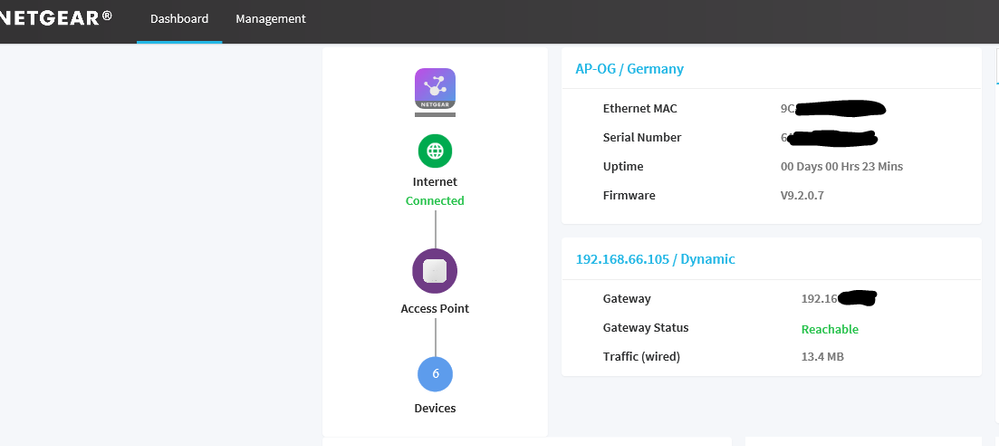

And the dashboard of the the device says:
Sorry but I have no idea what is going wrong.
Just thinking about to stop using the cloud and configure all via web inteface.
