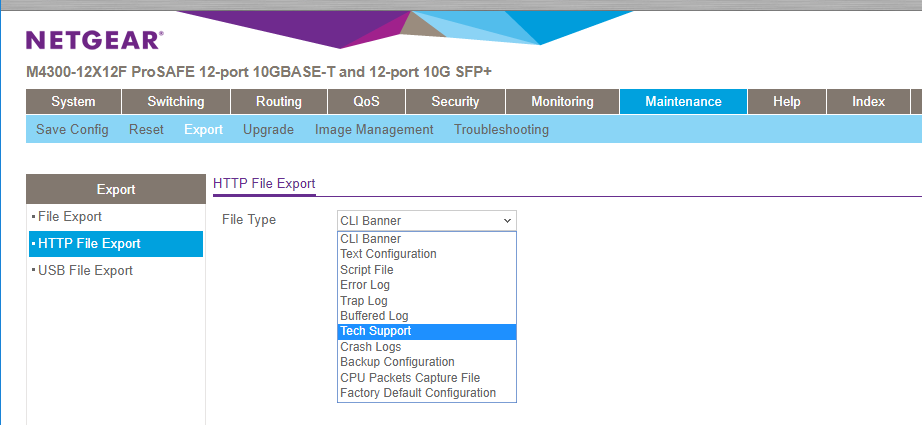

Please log into your M4300 stack when you see the issue (empty Dante Controller) and export the "Tech-Support File". To do so, you can use the Web GUI, go to Maintenance \ Export \ HTTP File Export and select Tech Support in the dropdown list:
Please send this file to me using Private Message (you can go through it on your side, this is a collection of show commands and other troubleshooting commands that are used to detect the root cause of an issue). The Tech Support and Engineering teams will work on your file asap and I will come back here to report on it. Thanks in advance for forwarding this file to me. If you can, please indicate in your private message where is the Dante Controller (which switch unit in the stack, which physical interface - port number) as well as a few Dante devices. It will help narrow the search. Right now we can already anticipate the mDNS packets are conflicting somewhere in between.
