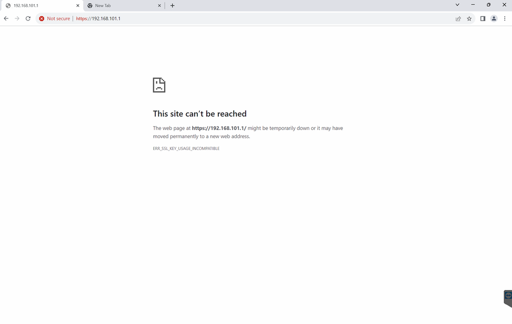

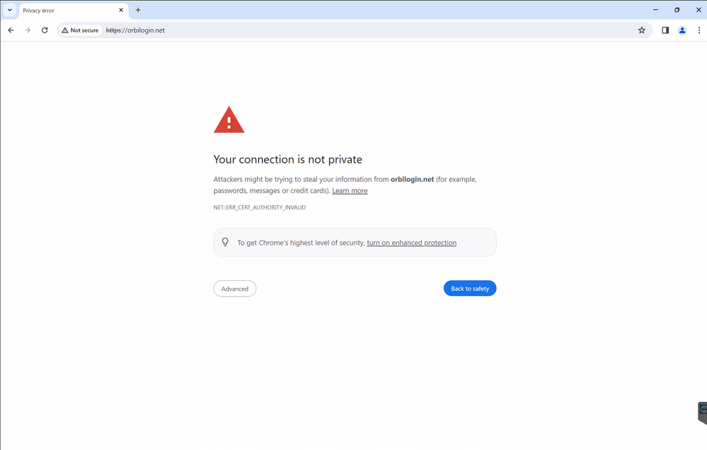

Nov 22, 2023Aspirant
Chrome Certificate
After the latest updates with chrome, The certificate is not secure and I get this: This site can’t be reached The webpage at https://192.168.x.x/ might be temporarily down or it may have moved ...
- Nov 22, 2023
Here is the solution I found:
We found a fix. Delete the user's local state file located in C:\users\(username)\AppData\Local\Google\Chrome\User Data\Local State. After deleting it the issue went away. Let me know if that works for you.
EDIT: Confirmed this is also happening on MacOS. Need to go to Library/Application Support/Google/ and Delete the Local State file from their as well.Thanks Everyone.

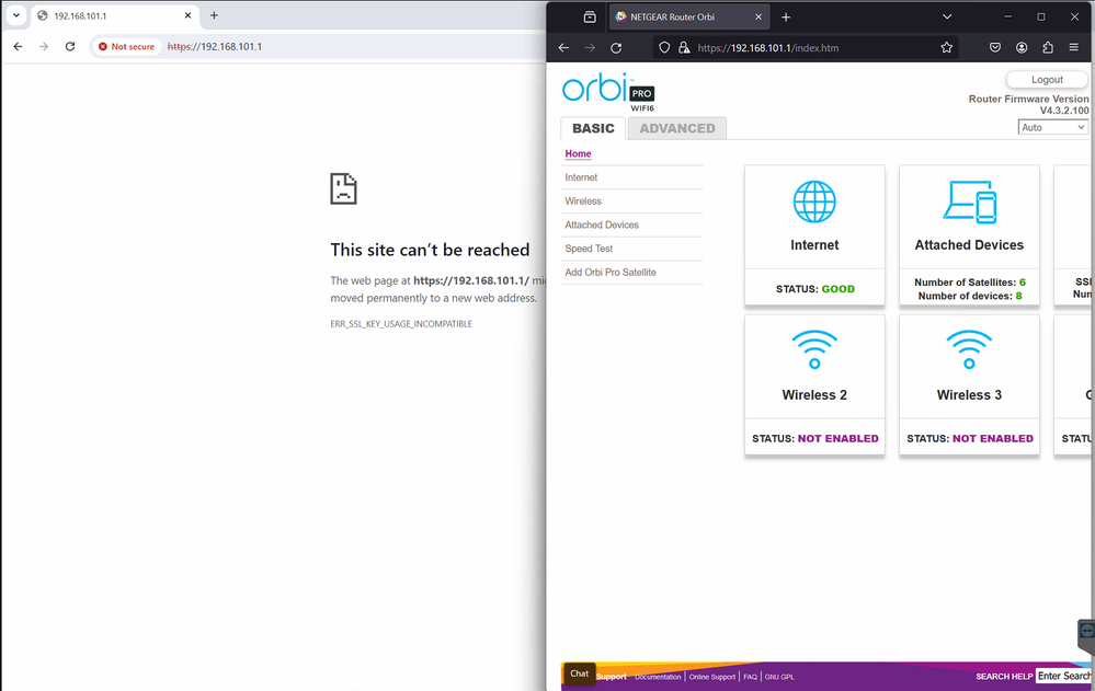

Chrome and Edge will not access the Management Login on the SXR80. The only way in is by using Firefox and this concerns me if this stops. Firmware is up to date. recently windows and chrome updates are the reason this has stopped working.
There are no options to change setting from http to https or vice verse and to make matters worse I can not log a case with netgear without paying $$$$ for a contract for them to look at and fix an issue with their browser compatibility.
Any ideas welcome as nothing in the thread here works. 1 screen shot showing chrome (left) error) whilst Firefox (right) logged in.
- schumakuMar 06, 2024Guru - Experienced User
Unluckily, ScubaSteve007 's post was moved here from the Orbi WiFi 5 section to this thread by a moderator, by error without my original reply.
The answer to the post above was given before here before. Netgear has released a patch for the SXR80 and SXS80 before.

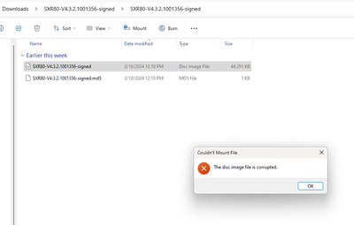

I clicked on the link for the Router in lieu of copying and pasting into Firefox, as at the end of the visual link was "..." I then copied the full link to Firefox. I then down loaded a ZIP file which had 2 other files.
SXR80-V4.3.2.1001356-signed Disc Image File
SXR80-V4.3.2.1001356-signed.md5
When I clicked on the Disc Image File I received an error message "The Disc Image File is Corrupted"
When I clicked on the Signed.md5 file the linked open to the following "SXR80-V4.3.2.1001356-signed.md5" and did not go any further.??

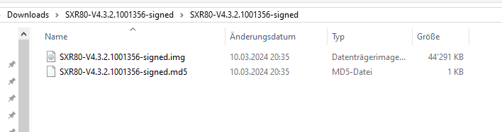

At no point, the fine documentation Orbi Pro WiFi 6 AX6000 Tri-band WiFi System (SXK80) User Manual does instruct us users to double click a downloaded file, neither on Windows, nor on MacOS, nor on a Linux desktop.
Follow the Manually update router firmware (respective Manually update satellite firmware) process, starting from p.163. Then use the ADVANCED > Administration > Firmware Update > Manual Update menu.
It's possible your modern desktop OS does not show file extensions under some conditions or settings, so you might not see the .img on the file, much more a Type like "Disk Image File" ... that's the one you need to select for upload:

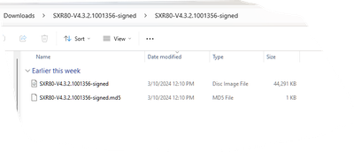

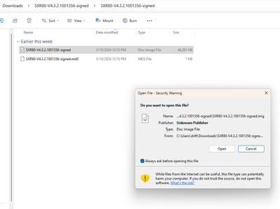

- KurtpfostMar 16, 2024Aspirant
Hi,
Thank you for the response I have down loaded 3 screen shots, first shot is the same as you posted, the second shot is after I double clicked on "SXR80-V4.3.2.1001356-signed", the third shot is after I double clicked on the file and I received a "Disk Image file is Corrupted"
I do not have programming skills, so any response needs to be stated simple.
