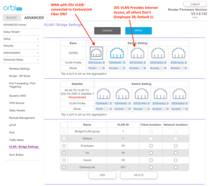

Trying to setup wired ports with Internet access on Orbi Pro 6 (SRX80). I have the Orbi router connected to CenturyLink fiber ONT, using PPoE with defined VLAN (201). The WiFi (default 1 and emp...

- JoeJoeJoeJoeDec 26, 2021Tutor
schumaku thanks for replying.
The Orbi is in Router and not bridge mode - see attached screen shot.LAN2 just enabled with no changes from out of the box configuration - see attached screen shot.
VLAN 20 is configured out of the box and as I mention VLAN 20 works fine for wireless clients. Just can't get to work as wired client, but VLAN 201 does work via wired Ethernet ports.
- schumakuDec 28, 2021Guru - Experienced User
Can't see anything obviously wrong - especially because the VLAN 20 seems to bound ok, unless there is some other space... BruceGuo do you see a chance for KB entry showing the config of a tagged WAN/Internet port config example on these devices? And then another KB entry showing the complete associations required for an existing or new network to the VLAN, Wi-Fi SSID, router and satellite ports? We see to many similar questions here....
